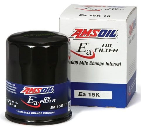

Default Amsoil Ea Oil Filter
I've read a lot of stuff about oil filters. The Amsoil Ea Oil filters have the best overall design & materials that I've found in an oil filter. This comment doesn't really address your original question but on the website I linked to below; the website states that there is less restriction during cold start up because of the synthetic filter materials. This is the filter I use for my 2013 Grand Sport.
(http://www.amsoil.com/shop/by-produc...ode=EA15K50-EA)
I read the same great reviews of this filter also, and what's very important is the fact that most engine wear happens on cold start ups, and with this filter, it has a important low restriction feature.
These filters in my area are hard to find unfortunately. I would need to order online to get them.
