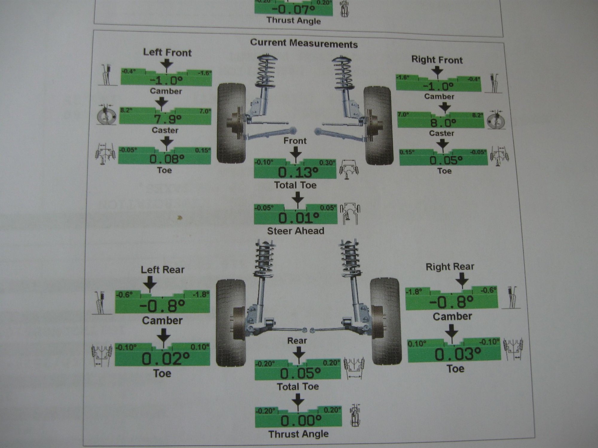

Do any of you get the trammeling I experience ?? I think I will swap the front tires side to side to see if its radial pull, but then I get some pull one way then the other, some times straight Car was aligned but by the dealer so I don't know what to think. Wear is pretty even though, on Nitto Invos ???
Here's the set-up for your consideration.
Thanks
NSF

Yes, I get it. The wide tires tend to track the grooves in the road.
The correct term is "tramlining" so you can google it. Here's one short article on Wikipedia that might help explain it: https://en.wikipedia.org/wiki/Tramlining

So my alignment looks OK ??? Think I should try swapping tires side to side? or is it necessary?
Maybe its the Nittos?? It is annoying.
NSF
NSF
Could be the nitto's.
I have invo's with about 5k miles on them and they travel on the highway. When i had my PSS's it was smooth as butter.
I think that's how invo's are when they wear. My car is aligned too.
NSF
I don't know off hand what the alignment specs are. I am hesitant about switching side to side even if non directional because they're going in opposite directions then and I suspect that the tires are sorta set to go in one direction now that they've been on the car. I know when I get my other cars' tires rotated, they just go front to back, not in an X-pattern. But we can't do that on the Vettes.
That article said softer sidewall tires don't have the tramlining problem as bad. I suspect it's also the low profiles we have, which effectively make them stiffer. And you with a GS have even wider tires than I have on my base (I think your fronts are the same size as my rears).
BTW ... I have Michelin PSS non-runflats and they still have the problem to some degree. My Caddy ATS and Subaru Forester don't do it, but they have narrower tires.
