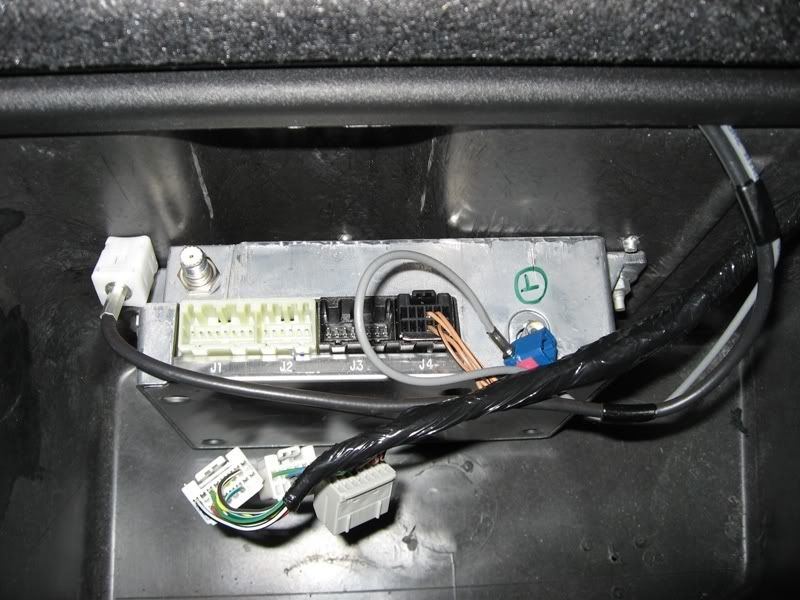

Most likely you have something not turning off. If you have a multi-meter, wait 20 minutes or so after you shut off the car. This will assure all the auto shut off components are off.
The reading in milliamps should be no higher than 7-14 Ma.
If it's higher than that, then you have a parasitic draw that you have to find.
Some of the common areas are:
1) 2005 Manual transmission, you must leave the transmission in Reverse when you shut it down, or it will drain the battery. This does not pertain to 2006-2013 vehicles
2) OnStar Module has been known to get a glitch and start drawing current even with the car off. If you suspect the VCIM (onstar module) then unplug all the connectors but the one in the pic, and the parasitic draw will go away.
3) Do you leave I-pod or such plugged in to your accessory plugs? Even if the IPOD devise has been unplugged, this device must be removed from the vehicle completely. The devise triggers the Bus to maintain power even when the devise is not powered.
4) Pull the fuse for Courtesy lamps. One of the culprits is the under hood lamp, if your car has one. Unplug the connector (right side of radiator)
5) 2005-2013. Are the headlamp or day time running lamps lit? With the key off there should not be any lamps lit. Perhaps the headlamp switch has been inadvertently turned on. Remember the only time the headlamps are turned off are in the off position or automatic. If the customer has turned the stalk to parking lamps or headlamps the headlamps will be lit when the ignition is off. There should be a chime to remind the driver the lamps are lit but often times the chime is ignored. These are on the 20 minute battery saver circuits but it does not take many short start and stop trips to draw the battery down to a voltage that will not allow the car to start 2005-2013.
6) 2005-2013. Is the radio still on? There have been reported cases where the radio stays powered up after the vehicle is shut down. This has been an intermittent complaint and it only occurs on cars equipped with the Bose systems which is the multi-disc player and the Nav radio. Only service the radio if this concern can be identified. 2005-2013.
7) 2005-2013. Close both doors. After 2 minutes are there any interior lamps on? Visually check the map lamps on the rear view mirror and vanity lamps. Often these lamps can be bumped and if the car is only driven during the day it will not be noticed. Under dash lamps are controlled by the courtesy lamp switch. Many customers do not realize that the switch has been bumped and they have been turned on. The old switch (C5 cars) used to push in and you could tell it was off. The new switch (C6 cars) does not press in. It can be bumped and turned on and go unnoticed. There should not be any lamps on in the interior of the car after 3 minutes if the ignition has not been turned on, including the cluster. Note anything that is on.
This should give you a starting point on what to check.
Good Luck, and report back if you find the culprit.
And...a battery tender is a must if the car sits for long periods of time. That will assure that when you go to start it, it will.
