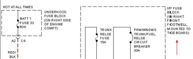

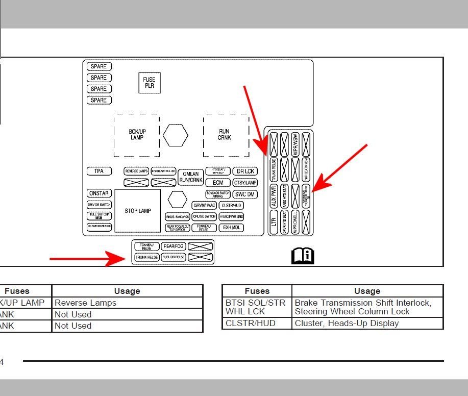

Thank you. Another update. I went to check 2 fuses ( hatch release and tonneau release) and it looks like they aren't there. Am I reading the diagram correct? Looks like there should be more than one large fuse in the section I circled in red and blue. Can anyone shed some light on this?
The 2 fuses your looking for are found in the passenger footwell :
I'm not sure why it shows 2 trunk relese fuses??
I figured that out, but if you look at the pic it doesn't look like those 2 fuses are there. Those 2 fuses are in the diagram I circled in red and blue. That diagram doesn't match up with the actual fuses that I pointed to, right?
It's on the side of that main fuse panel under the cover.
Thank you, I don't know if my computer didn't load this pic in the last post or you edited the original post, but I didn't originally see this. Will go check it out now!
Thanks
YW,
I also added the pic of the Footwell fuse panel, The one on the side, remove cover to uncover fuses.

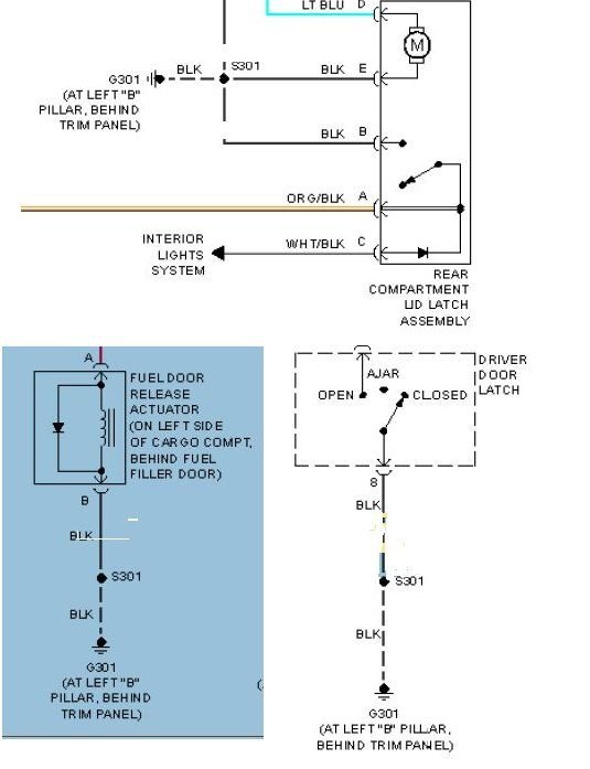

It's located to the left of the "B" pillar (Halo) behind the trim panel rear of driver seat.
Thanks, if the ground is loose wouldn't the other components that are also relying on that ground not be working?
If the ground is loose, then yes, all circuits using that ground would potentially have intermittent issues as well.
Here is the 3 circuits that use that common ground
in the C6 Coupe/Z06
For the rear hatch assembly, you should check that the connector pins, including the ground wire is in good condition, and the wires are in good condition, not pinched, etc.
If all that checks out, then you have a bad assembly that needs replacement.
