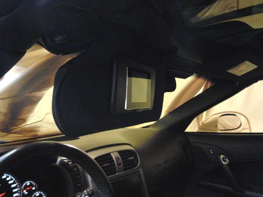

There was a lockpick 360 that was available to add a video input to the OEM Nav, but it was troublesome, and are no longer made.
A new company, Navtool now does it, but it is pricey, and the unit has to be sent to them so they can add it. PITA.
I added a monitor to my driver sunvisor, replacing my vanity mirror assembly. It takes patience to do it, and a bit of work but doable.
I removed the vanity assembly, leaving only the wires for power for the homelink. I used the vanity mirror cover, cut an opening in it to fit the monitor very tightly all the way around, and attached it to the sunvisor using clips and tie wraps under the cover to hold the monitor to the sunvisor.
