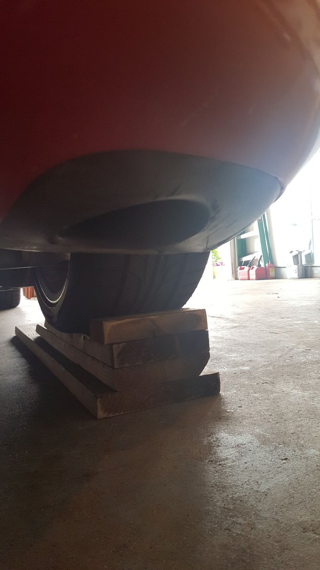

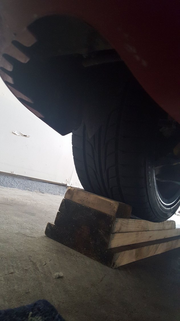

Can someone tell what this black part is call, I seem to be missing the one on the driver side.

Is that on the front? If so, it appears to be the brake air inlet for the brake duct that leads to the front rotors.

Yes the front is that the name of it I've been trying to look it up but can't find it. Thanks

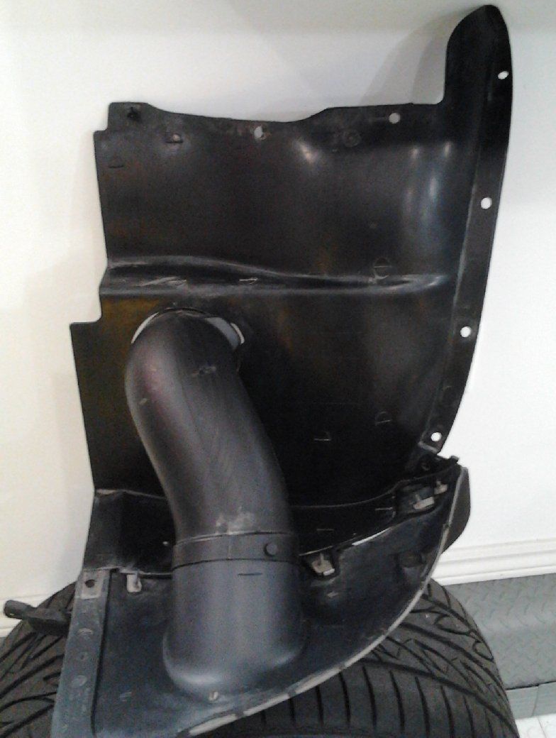

It's a passenger brake duct assembly (also known as liner extension), which attaches to the inner fender liner as per the pic. If the bottom section is broken, then the liner may also be damaged.
DRIVER SIDE

Yep just checked it is broke, that dont sound promising

The (3) plastic parts that you need are not that expensive.
Passenger (RT) Fender Splash Shield (inner fender liner) Part # 15233300
Passenger (RT) Fender Liner Extension -Part # 15252927
Passenger (RT) Front Brake Caliper Cooling Duct -Part # 15252919
All these are available at Corvette Recyling.com for
Part # 15233300 -$24.99
Part # 15252927 - 20.00
Part # 15252919 - $7.99
Hope this helps.
