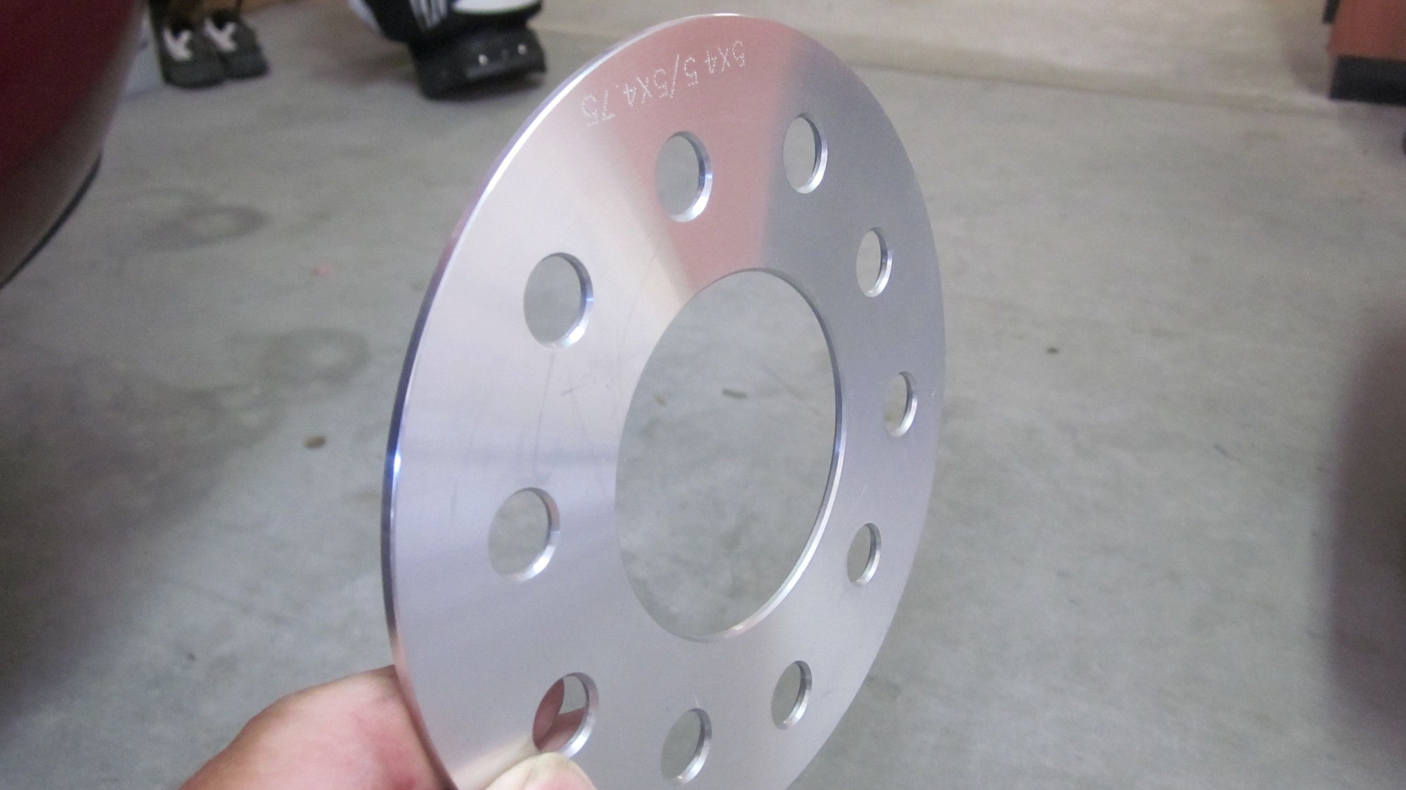

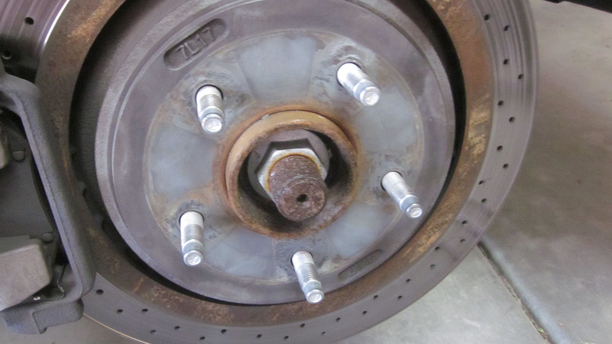

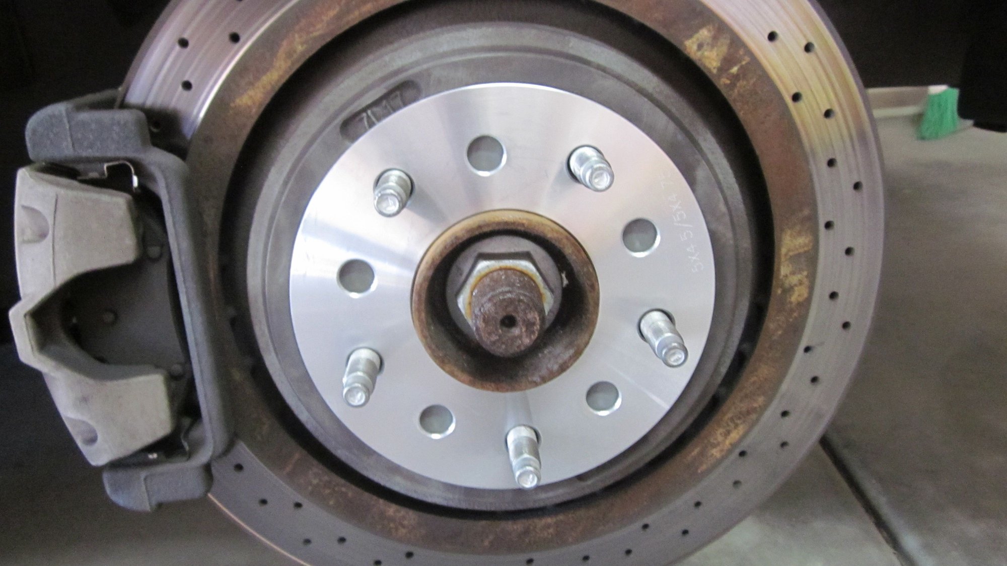

What color? Chrome, grey, or black? I bought my chrome logo center caps on eBay. They are supposed to be genuine GM caps, although my wheels are reproduction. I'm not sure which is at fault, the wheel or the cap, but when I installed the caps on the rear wheels, the inside of the cap hit the axle. I had to use a 1/8" wheel spacer to gain enough room between the axle and the cap. No big deal, just notable.

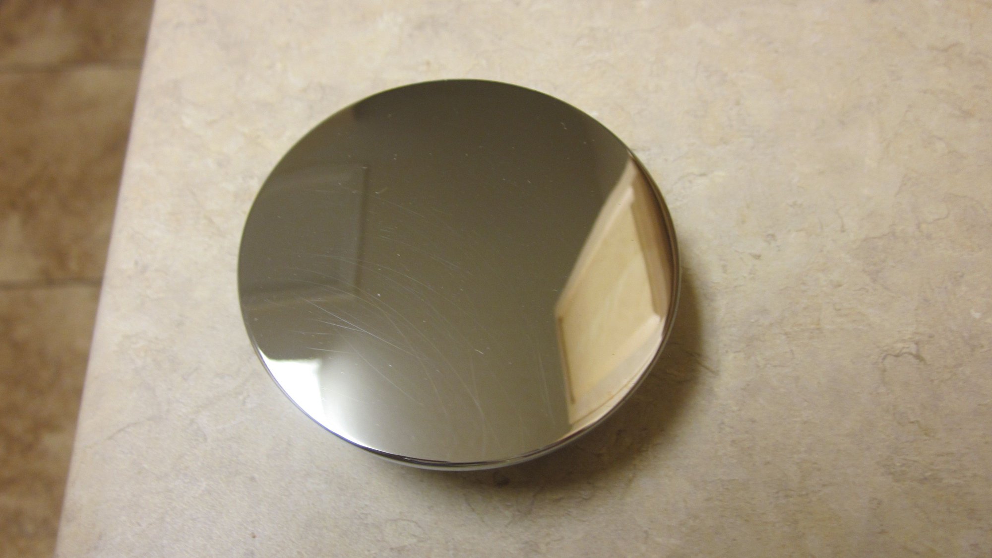

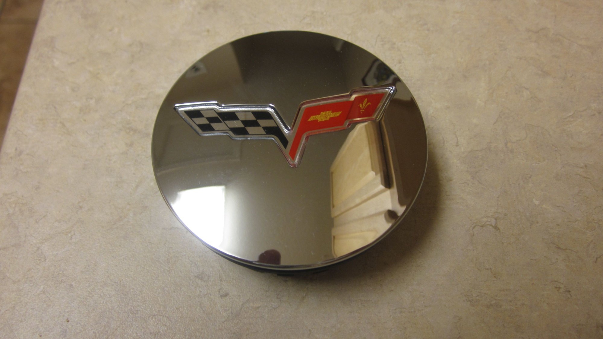

This image shows the difference between the plain caps that came with the wheels, and the logo caps that replaced them.
This part of the axle is what the logo caps hit against.

I really want to avoid any sort of spacers, so hopefully whichever I buy it don't have that fitment issue. Thanks for the replies guys.
