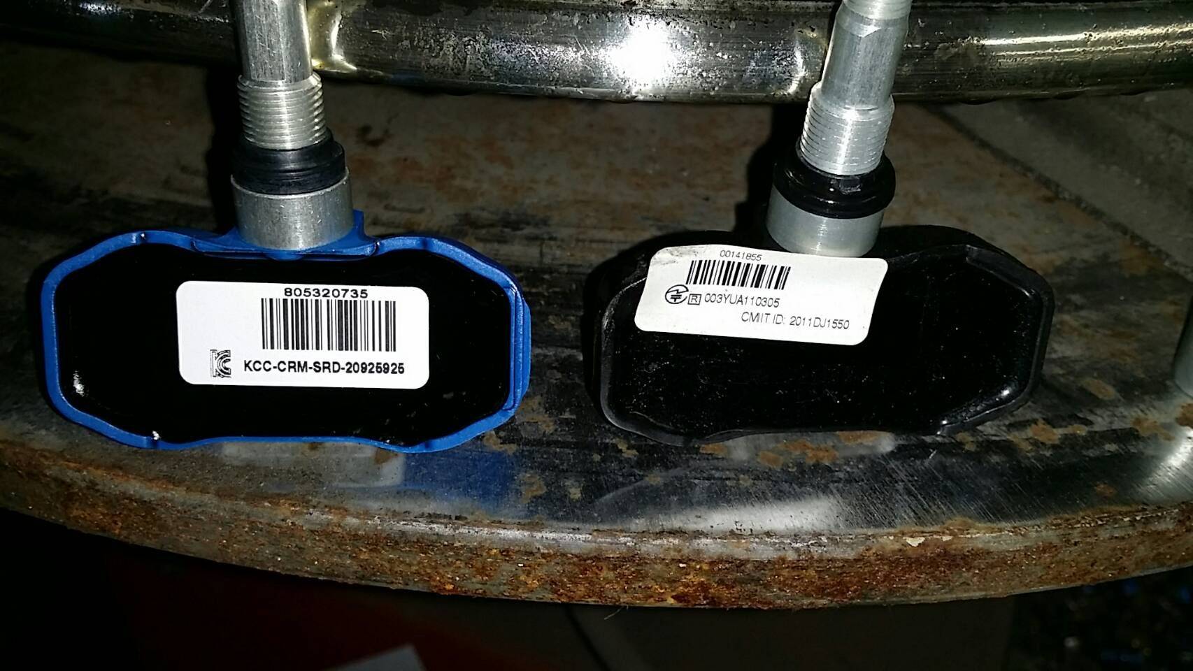

My right rear TPMS sensor went south. I ordered a new sensor from GMPARTSHOUSE (part # 20925925 TPMS SENSOR, RIGHT).
I used the ATEQ VT5 trigger tool to register the new sensor, but it failed to register while other 3 sensors registered fine.
What gives?
The new sensor is the left one (blue casing), old sensor is the right one.

AC Delco part # 25758220 fits all 2005-2009 Corvettes. The 2005-2009 sensor won't work in a 2010+, and the 2010+ sensor won't work in the 2005-2009 Vettes. I'm not sure if the part # that you got is for 2010-2013 or not.
I believe that the Z06 and ZR1 take a different sensor that a base or GS model.
What is the year and model of your corvette?
You can contact Gene Cully at Cultrag Performance and he can tell you what sensor fits your car.

I think I remember that export models use a different sensor. I know that's true for the C7, but can't confirm for the C6.

First, I am not understanding why the sensor description says RIGHT because the four sensors for the car are all the same, there is no left and right designation. The catalogs usually list which TPMS system the sensors are designed to work with. On the options label in the glovebox door is listed which system the car has...it is the code starting with "U"...for example "UJ9". If you check that sensor with your Ateq and get a response from it, (separate from programming to the car) but the car will not register it, then it is not the correct part. If you get no response from the sensor on the Ateq, then its' battery is dead. Get that "U" code from your label and check the sensor part number against it. Even on Amazon, they designate them with this code.
For example, this is the one for my '07 Vert...notice in the title that they have the code (UJ9) in parentheses:
http://www.amazon.com/ACDelco-25758220-Original-Equipment-Pressure/dp/B0010GHTDE/ref=au_as_r?_encoding=UTF8&Make=Chevrolet|47&Model=Corvette|440&Year=2007|2007&ie=UTF8&n=15684181&s=automotive&vehicleId=1&vehicleType=automotive http://www.amazon.com/ACDelco-25758220-Original-Equipment-Pressure/dp/B0010GHTDE/ref=au_as_r?_encoding=UTF8&Make=Chevrolet|47&Model=Corvette|440&Year=2007|2007&ie=UTF8&n=15684181&s=automotive&vehicleId=1&vehicleType=automotive

Well, things are more complicated than I thought. I did order the wrong sensor. The one I ordered part #20925925 was for the Euro. Part # 20925924 is for the US cars.

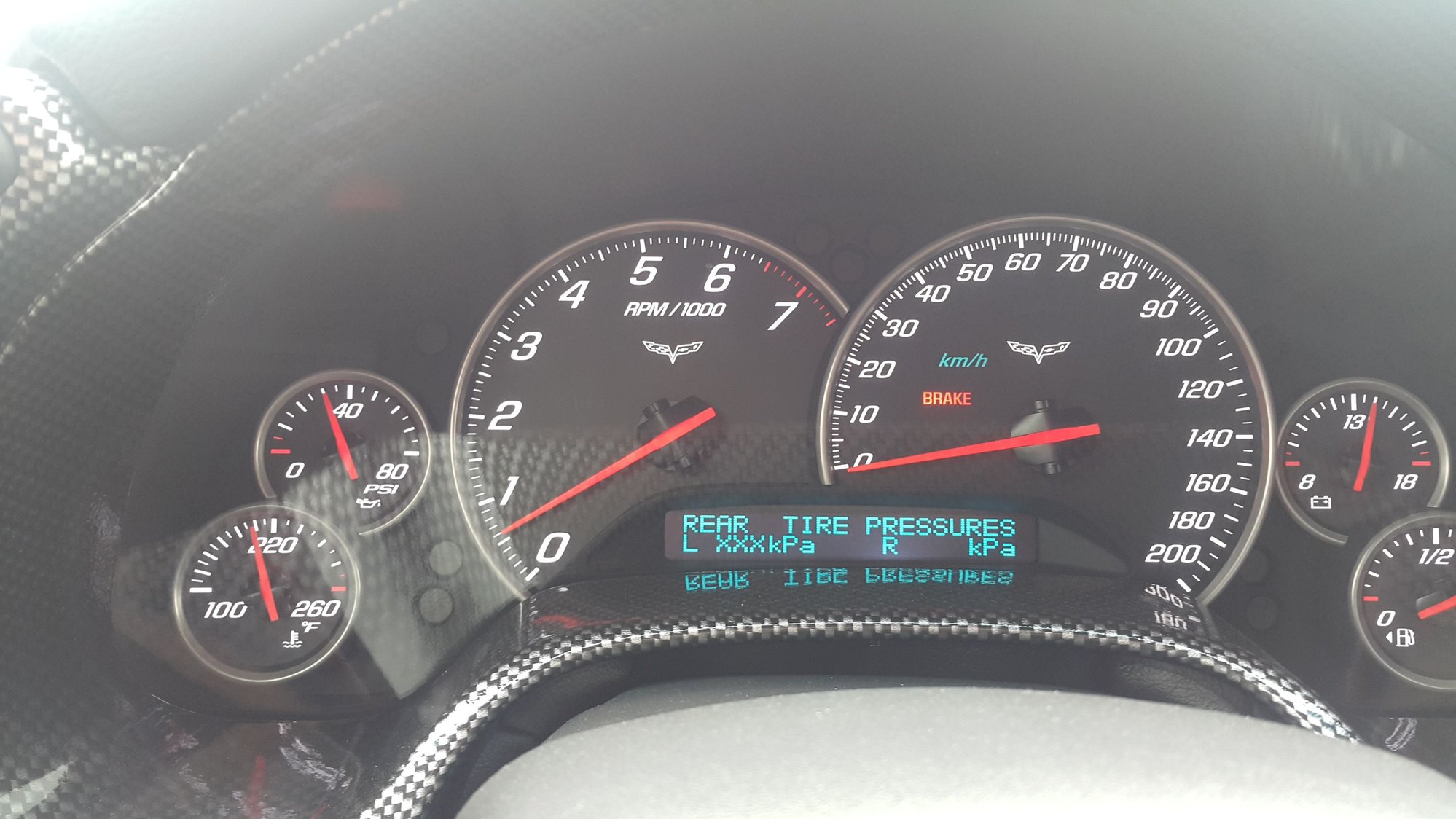

But sensor may not be the problem. I moved the right rear tire (which could not register and showed XXX) to the left rear, and the original left rear tire (which was good) to the right rear, the tried to register them. I got the following. Maybe the TPMS signal receiver is bad. Does anyone know where is the signal received?

Moving them around the car has no effect whatsoever. The wheels could literally be sitting in a stack on the floor next to the car and still be read by the TPMS system. If the car will accept the other three but not this one, then the sensor is wrong or dead...simple.
The reason that the sensors are programmed starting at drivers front and going clockwise is that the car is expecting them in that order. The result of moving them as you said is completely expected. But understand that you could take off all four and lay them flat on the ground and still program them to the car (if the sensors are working properly.)
I would still ask if you are getting a response from that questionable sensor on your ATEQ?

Thank you for the referral. The customer was sold the incorrect part from the previous place he purchased. He purchased the correct part from us today and all is well.
