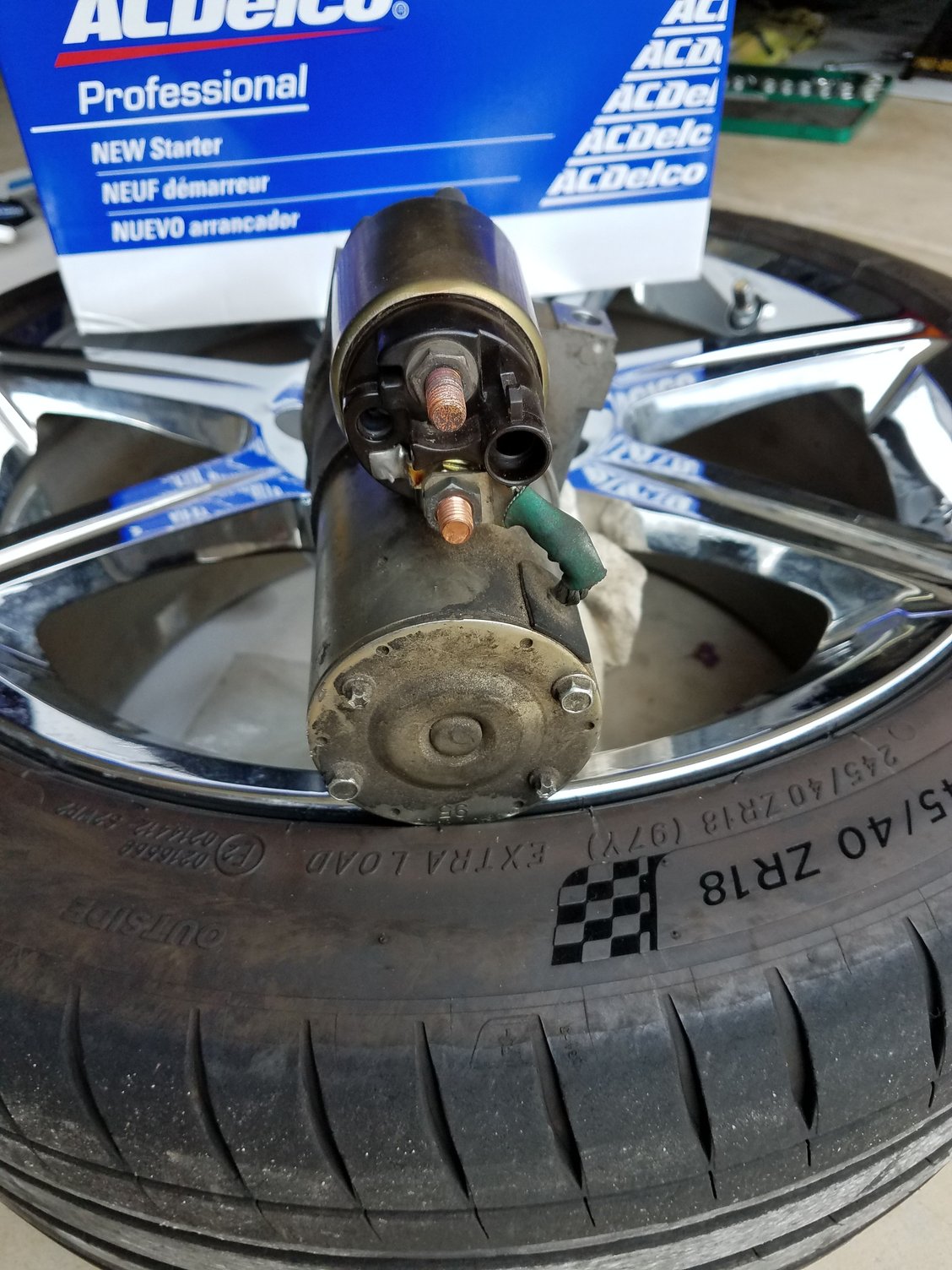

Originally Posted by mikeCsix
In looking at the picture of the starter, the key to the issue is the corrosion on the studs.
The studs are copper, that's why they are that color. That starter has no significant corrosion on the terminals. Heat was the enemy here, not corrosion.
