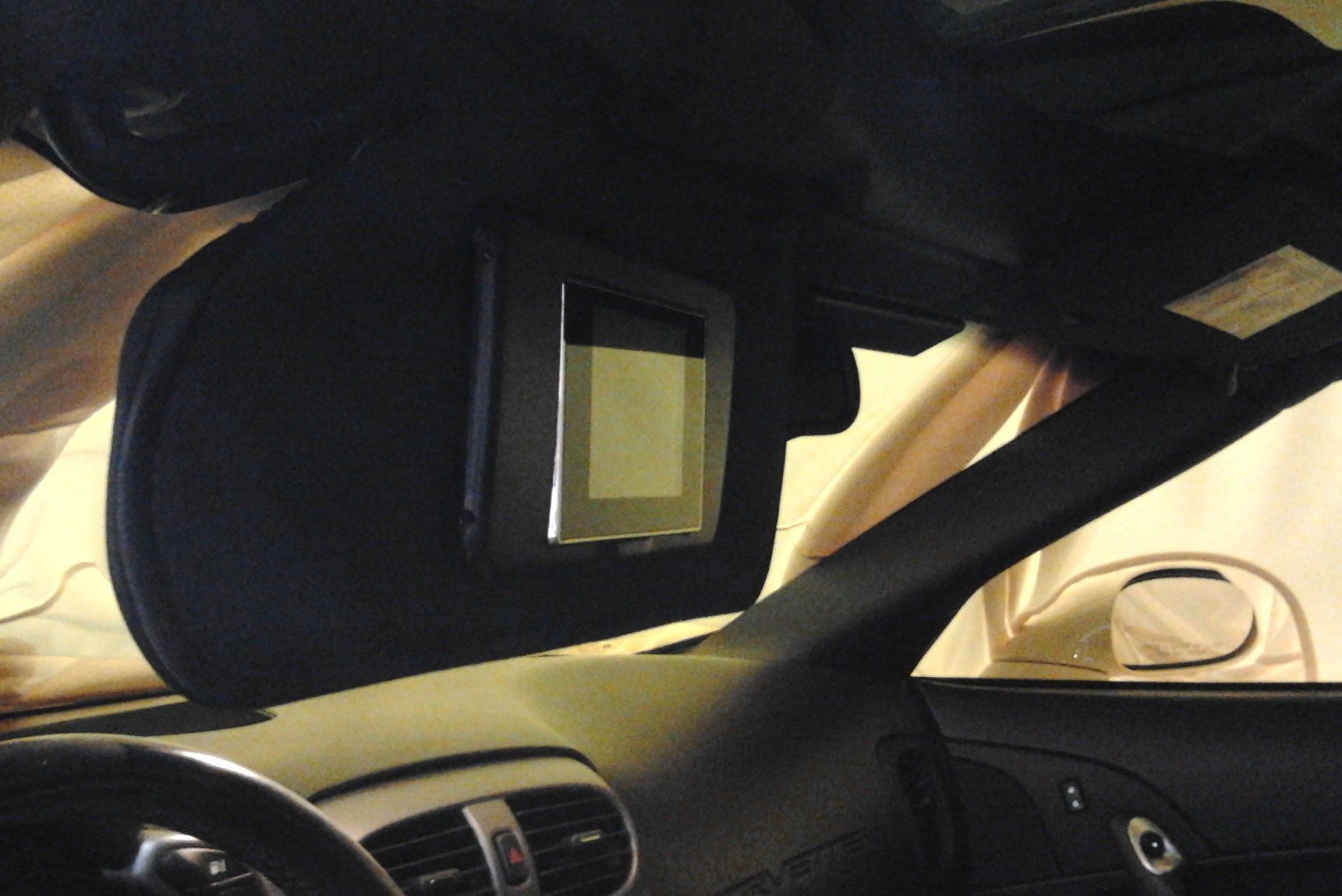

I did this many years ago. I attached the camera on top of the center air dam under the front bumper. I had made a mount and attached the camera to it, then using the center bolt of the air dam, attached the mount/camera to it.
I ran the camera wires through a wire loom, under the coolant overflow tank, and under the brake booster, and into the cabin just above the dead pedal.
I mounted a monitor into the driver sunvisor, so it's stealth until I need to use the camera for parking.
I put some heat insulation over top of the camera to protect it from radiator heat.
I used a camera from Amazon that is a non reversing parking camera, meaning that it shows the image as you would see it.
The normal back up cameras are revered images.
Here is my camera.
And my monitor
It was less than $30.00 for both the camera and monitor back 4-5 years ago.
They still work as intended.
