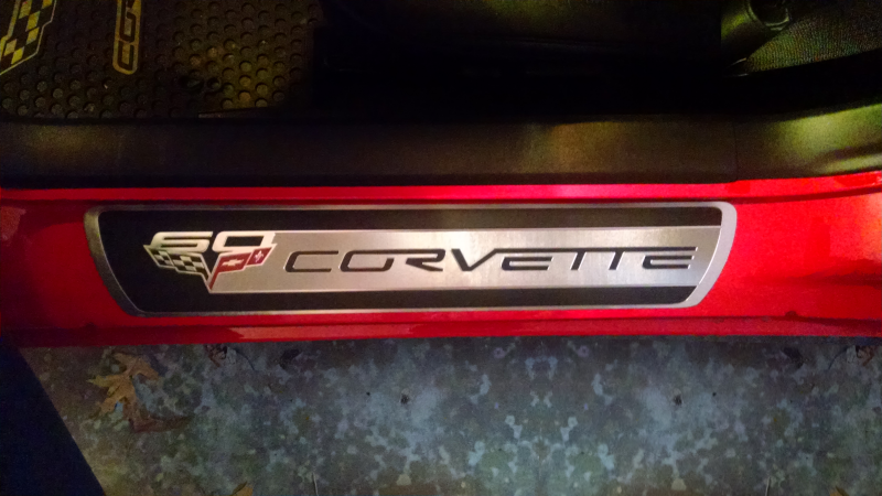

Default new sillls in place
Thanks for the info guys got the new sills installed last weekend.
My old 1's were a piece of vinyl with adhesive on every bit of the under side. Would up taking about 2.5 hours to get all the glue off and the new sills put down.
Would up using 3M adhesive remover some WD40 and then rubbing alcohol to clean up after the glue was gone.
I had tried some goo gone also but it didn't help much if at all so don't waste your time trying it.
Didn't use the fishing line under it because once u got a corner up it just peeled off in one piece. Then it was just cleaning up the adhesive mess.
The new plate is much nicer looking than that old 1 because some of the adhesive had leaked out and messed up the silll.
Here's the new 1's and the old 1's . What do you all think?
