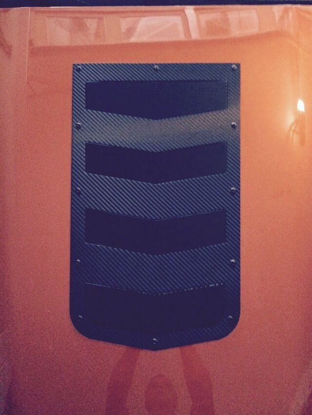

Ps.i think Painted rivets did the job 1968swbbblock.

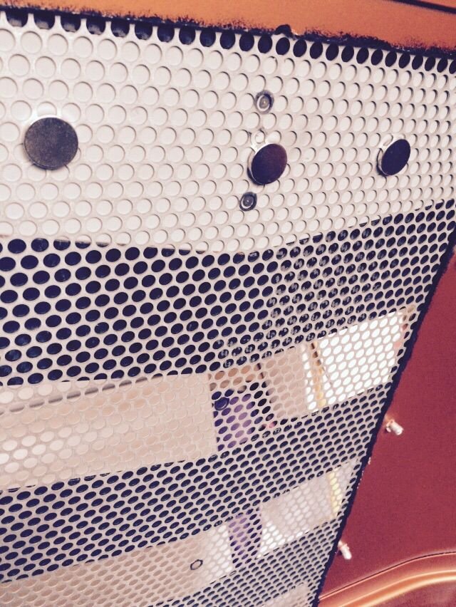

Wrapped rain covers. Small 1/16" gap around opening
Supermagnets

il look into those...these lil ones are rated to 6 lbs of force each!! so i got 18 lbs of force in each plate....there's is no way they are coming off by themselves..i struggled this morning taking them off without a screwdriver...i need rain now...

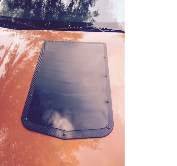

ok so for the next test i introduced water to the hood vent to see how much it would leak inside the engine. so with the rain covers on there is about a 1/16" gap all around the covers. So i knew there was gonna be water on the SC cover..but it did fall off the cover shortly after- i imagine with the car moving it wouldn't be that much of an issue...so they will work by not letting tons of water in the engine but will not be completely sealed watertight,,,
the next mod was adding a new cover that would go over the entire vent on the outside. I used a magnetic sheet cut the same size of the vent. this one did keep the SC cover almost all dry...very small amounts of water...i did keep the previous rain covers in place with the super magnets and just laid the sheet over it..that seemed to have helped keep the sheet in place. only concern was the pull out strength of the sheet while driving....will test that next few days..
I guess there are pros and cons about doing this neat mod...the main pros is good temp drops during normal driving and at the track, then maybe- fairly decent look of this hood vent - some may object.., cons would be maybe water on the SC cover/ engine compartment and having to deal with putting the covers on and off. most likely will stay on during winter driving and during rainy seasons..
end result - im pleased with it....i satisfied my main objective - to lower engine temps....you decide if its for you
enjoy the pictures.

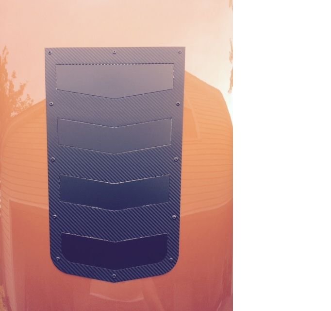

magnetic sheet over rain covers
