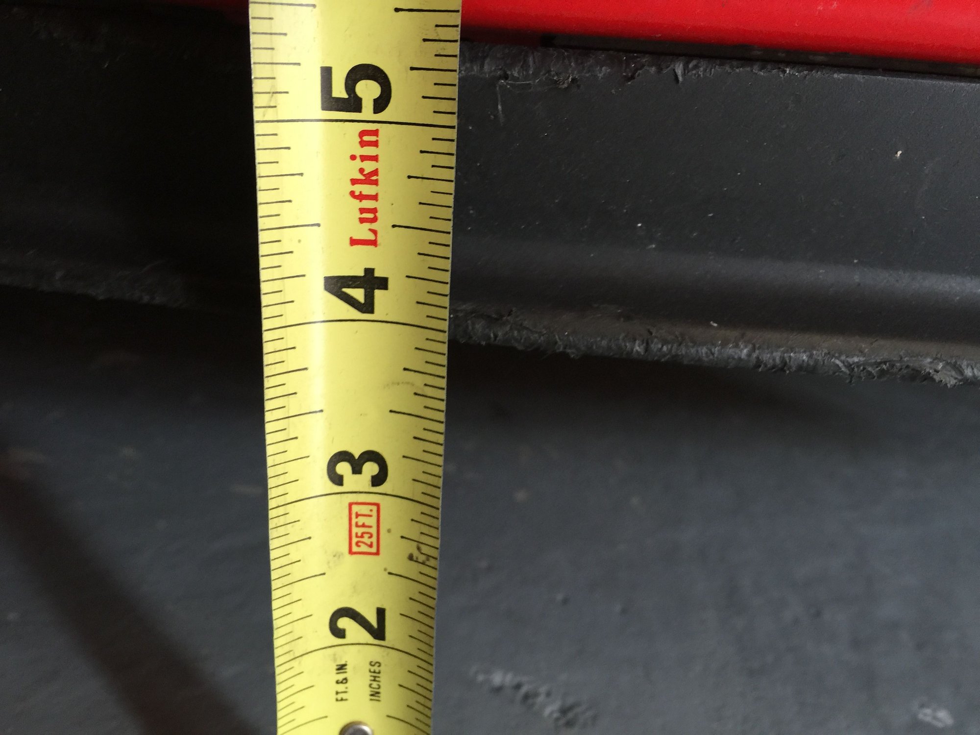

My air dam is 2 3/8" from the ground.
The front splitter is 3 7/8":
93K miles of daily driving and autocrossing scrapping. While both my air dam and nose has some cosmetic damage, they're both decent shape.
You can minimize the scraping with the standard "enter driveways at an angle" advice. Basically you're driving one tire up the driveway first and lifting the nose with it to avoid the scrape before the second tire starts to climb the driveway.
Another something that I do all the time that's a little unnerving the first couple times you do it. Next time you get to a dip in the road or a high speed bump that you know a scrape will happen try this: Brake till you know your nose is inches from the scrape (to compress the front springs a bit), then just pop the gas a bit to lift the nose of the car up (and get a little bounce from the front springs decompressing). It's totally counter intuitive the first couple of times, but once you've got it figured out, you can avoid 90% of the scrapes that you would normally have if you just crawl over or through the obstacle. It's a bit of an art form (kinda like learning rev matching), but it's second nature to me now, and darn it, it works like a dream once you've got it figured out. Although admittedly, you sometimes look like a douchebag when you pop the throttle in a parking structure or something.
Either way, no need to remove that air dam. I'm sure you're not going to be any lower than I am. The scrapping isn't too bad if you learn how to avoid most of them.
