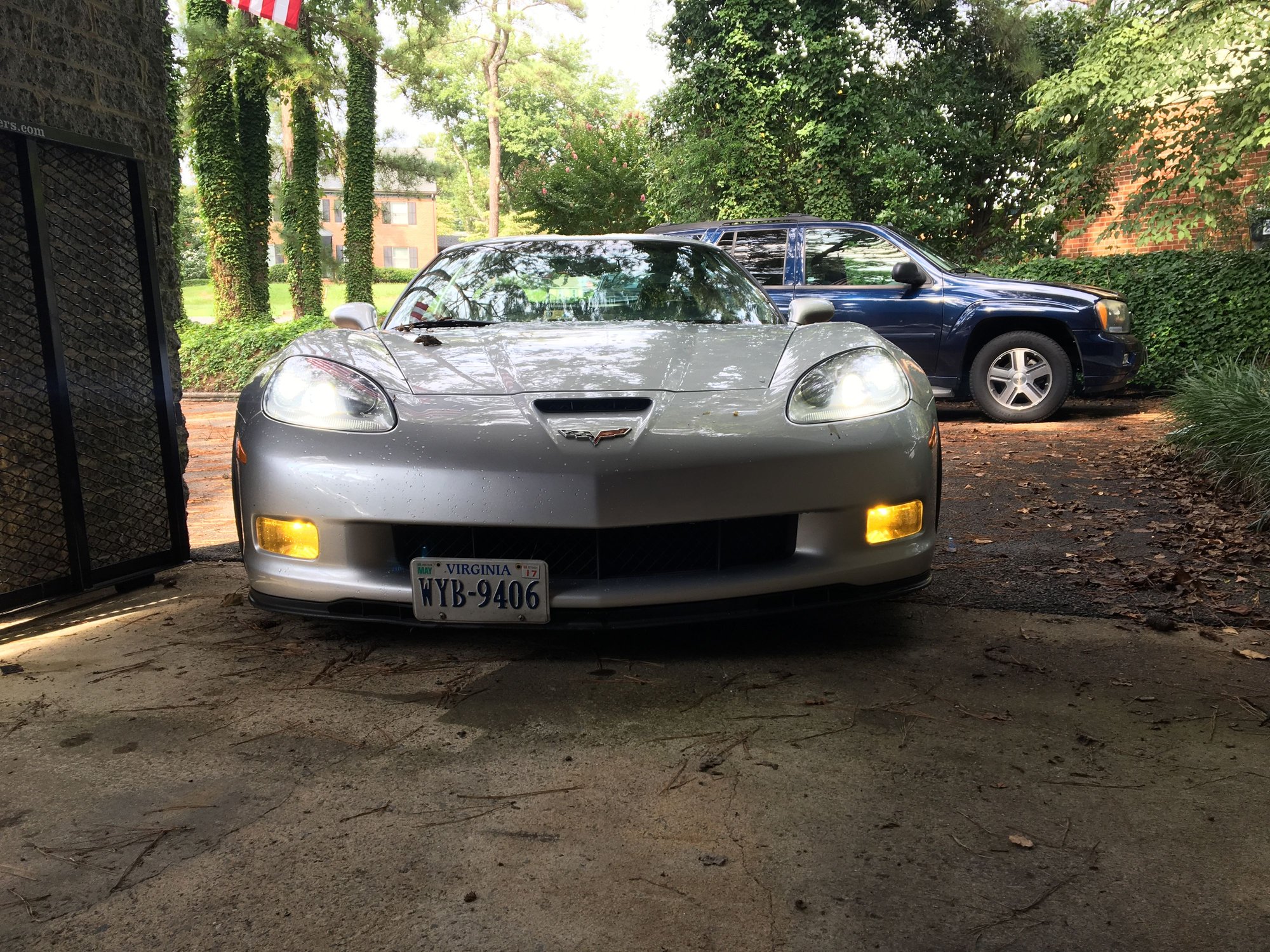

So I just finished the install. I skipped the resistors as I kind of like the hyperflash.
Took me about 15 minutes to do both sides with DRL and fog light bulbs. Would have gone faster if I had jacked up the car and taken the wheels off.
I did have to remove the three retaining screws from the fog light housing in order to make the bulbs work, the base of the bulb is a bit larger in diameter than the stock bulb so it did not want to go in 100% though it seems like the gasket has it sealed. I put them back in place over the tabs once the bulb was inserted.
With the car slammed on the stock bolts it was very tight getting my hands in there and manipulating things, but it was worth the effort.
The car is dirty from its weekly commute, tomorrow is wash day, be gentle.
I really like the look and hope that the fogs will work better on a foggy morning than the stockers.

I wouldn't hold my breath for performance from those fog lights. The "plasma" technology use in those bulbs is over 5 years old. You are barely getting a few hundred lumens output with them.
A better choice would be some of the newer high-output LED bulbs. These usually have a small fan attached to the back to aid in cooling.
These might be a better choice:
http://www.ebay.com/itm/2016-80W-800...BW6eYK&vxp=mtr
Note: the lumens testing may be a little off, but they are FAR brighter than the plasma or even the Cree XP-E or XP-D type bulbs which are suitable for brake/turn or marker purposes.

Actually, there is an LED projector on each bulb. They throw a pretty solid light pattern.
