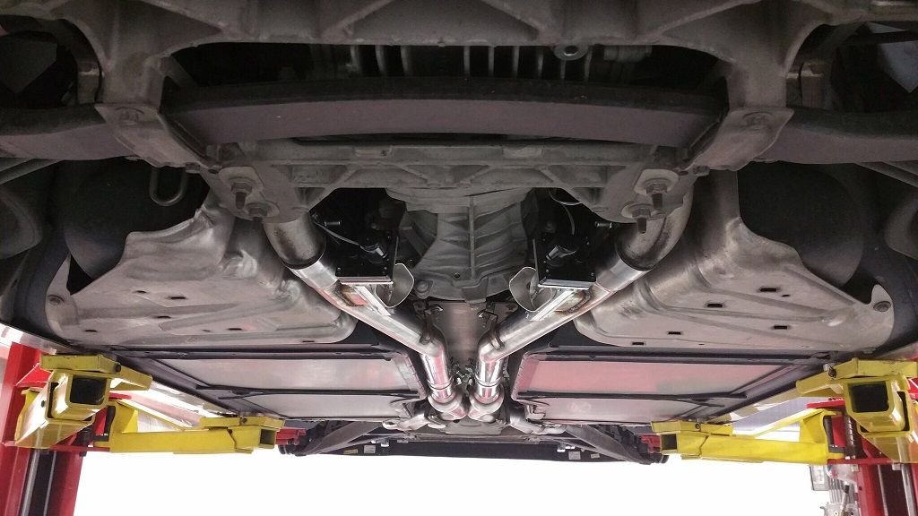

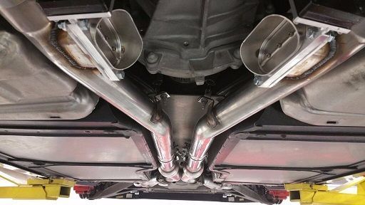

Originally Posted by Naldinator
I say skip the changing exhaust and go with a set of cutouts.
Love mine. Whisper quiet when I want and obnoxious thunder when I want that.
That sounds like a great idea! Do you have any pics of your mod? Do you have an exit pipe welded on, or just exit under the car? Thanks
Old Aug 10, 2016 | 12:31 PM
  #35
Naldinator's Avatar
Naldinator
Joined: Aug 2015
Posts: 632
Likes: 69
From: GA
Just exits under the car. It does get a little exausty if I sit still too long, but man I love the sound
