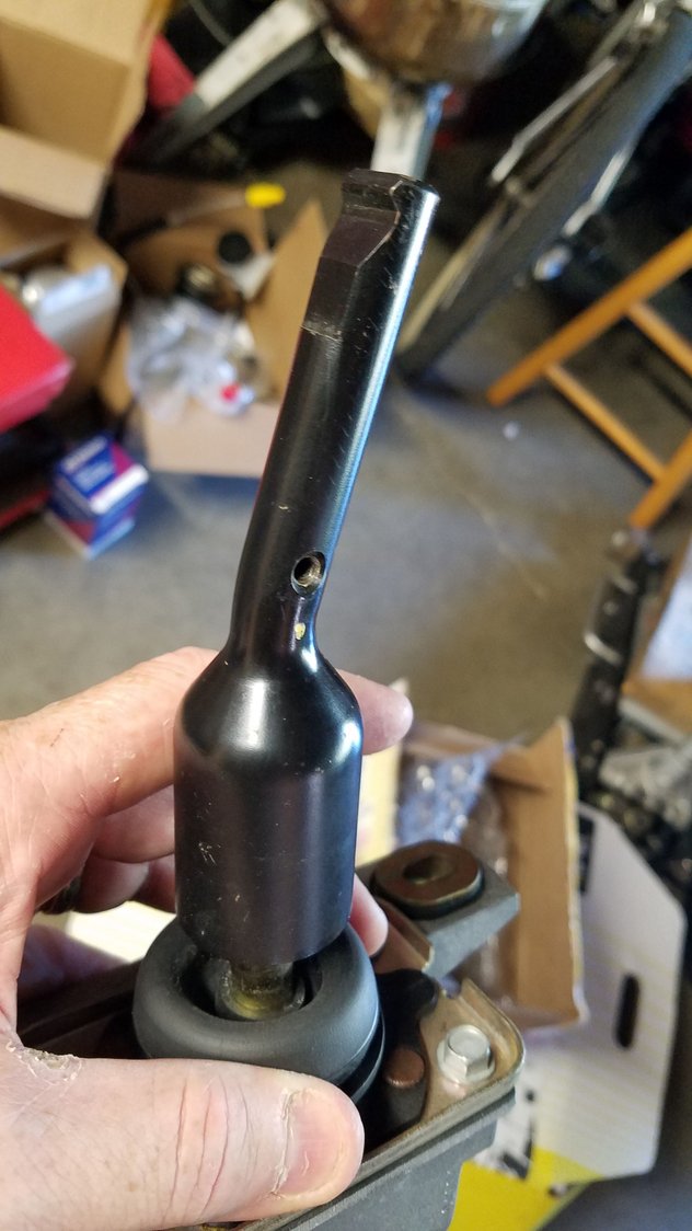

this is the one, can anyone tell by the pic which style it is?
Could be wrong, but looks like the 05-07 style.

Do these pics help anyone to identify the year it came from? I'm kinda leaning toward 05/07?
that is definately not 08+ that is for sure

I can tell you that your picture is NOT of a 2006 shifter. I compared it to my old stock shifter and the screw hole in your shifter is located higher on the rod than mine. Everything else looks the same.

Yep, early C6 shifter hand the bolt channel for the **** right after the bend part.
With the bolt channel higher, its for a late model shifter **** and will use the late model **** on the right, as well as the shifter boot that has the top ring to snap into the late model *****.
Not this type boot, which is for the early model ***** to snap into the annular groove isntead.
Now having said this, you can use a early model **** and boot with the late model shifter, but will end up with the **** being about a 1/4" higher on the shaft than normal isntead. This will make the shifts longer, as well as add in the amount of slop on the OEM shifter too.

Ok, so I am looking for an early c6 shift **** then. Thank you gentlemen. I'll see whats out there. If they are too expensive I'll just thread the damn thing and put my black C5 cue ball on it and be done.
