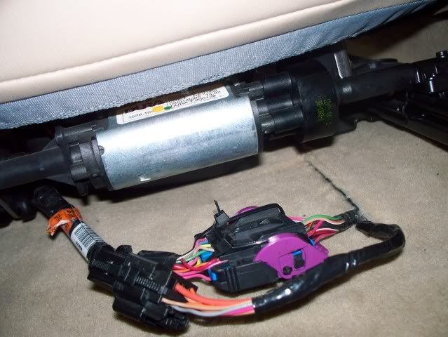

I have searched the forum for pictures of memory seat module.
Removed drivers seat and I do not see one.
Also, have connector that goes to nothing.
It appears to have been bypassed somehow?
From what what you can see in the pictures, can any one tell me what parts I need to get it to work?
Seat goes forward and back both bladders work but no steering colume movement or easy exit or memory.
Thanks
Top connector goes to nothing
I do have memory
No seat memory module that I can see.

Sorry I should have stated I found many pictures on the forum w/memory seat modules.
However, under my seat I DON'T see a module.
I was hoping someone would see my pictures and could tell me what the extra harness is for.
And could figure out what the previous owner had done.
The seat where recently reupholstered.

I believe the memory for the seats comes from the body control module. C6 seats are one of the most complicated systems I've ever seen.
The connections should be for the power adjust, seat heaters, seatbelt switch, and airbags. If your car doesn't have all these options, you won't use one of the connectors.
Have a look at this link, this guy has some great information, including pinouts for all the connectors:
http://www.kawal.net/power%20seats.htm
Garry

That is one of the links I checked.
The very first picture on that link shows a black box to the right of the purple connector.
My seats have lumbar support, side bolsters, and are heated.
And they work fine.
Just no memory.
Thank You for your imput.

Need to know more about your car. As a for instance, a 2005 1SA did not have the memory package. 1SB did.
Just sayin...

I'm pretty certain that the memory module (black) is found under the seat in the middle front, between the seat frame and the front motor, and the connector comes out to hook to the one that you are showing.
Just sayin...
Is there a way to tell if its 1SA OR 1SB?
VIN #, sticker etc.
Old Sep 28, 2016 | 08:59 AM
Frankie15's Avatar
Frankie15
Joined: Jul 2016
Posts: 2,452
Likes: 495
From: Clearwater, Florida
VIN #, sticker etc.
On my '08 there is a sticker inside the glovebox on the left side with all the RPO codes. Not sure if its different for '05. It will say 1SA or 1SB on there.
Just sayin...
This is the glove box sticker from my 2005 C6.
Is there somewhere to decipher these 3 digit codes.
Go here:
http://www.corvetteactioncenter.com/.../2005rpos.html
Your sticker shows 1SB so if the module is not there it has been removed...
Looks like the tan module is also missing.
Do you know what that one is for?
Thank for the pictures!
I found the answer.
It is a seat heater control module.
