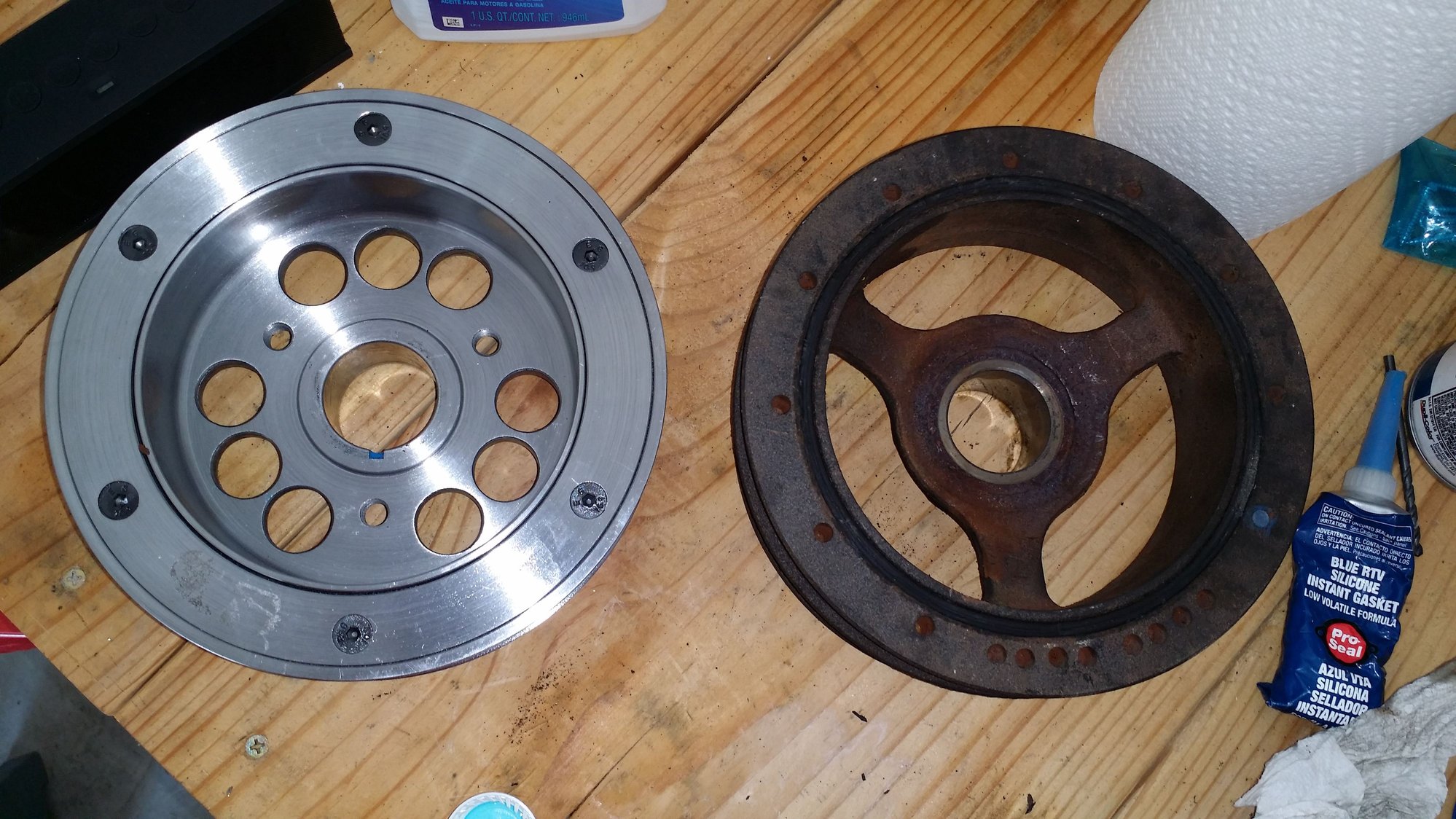

I used this one from Summit https://m.summitracing.com/parts/sum-c2501 and installed it myself with a friend helping me. You also need the seal that goes behind the damper, a new bolt and you might as well replace the belts while you are in there. I have been running this one since July and it spins true. Much nicer unit then stock and won't break the bank. I would say it's a good alternative to ATI. Whatever you do don't replace with the stock one.

New Summit balancer vs old stock GM balancer. No comparison.
