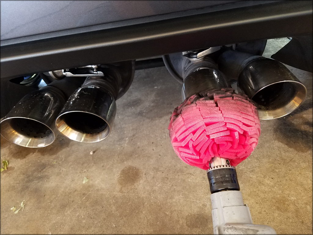

You can add a scotch brite pad on the end of your ball or steel wool like the other guy said. I use this method to keep them clean.
