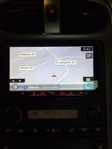

Welcome Pioneer AVIC 8200 NEX.

Awesome unit with Apple Car Play, Had it installed by the dealer. Took them about 2.5 hours. They have done C6's in the past.
Took a 1200 mi trip and after 5 hours I lost all audio. Returned to the dealer and the problem was that it wasn't supplying enough voltage to the Bose Amp. They had to add a relay that could handle 5 amps. All is good now.

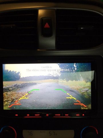

They did not cut any factory plugs or splice any wires, after market interface cables with matching plugs were used for the install. The backup camera is wired directly and the Mic is installed by the Gauge Cluster.
