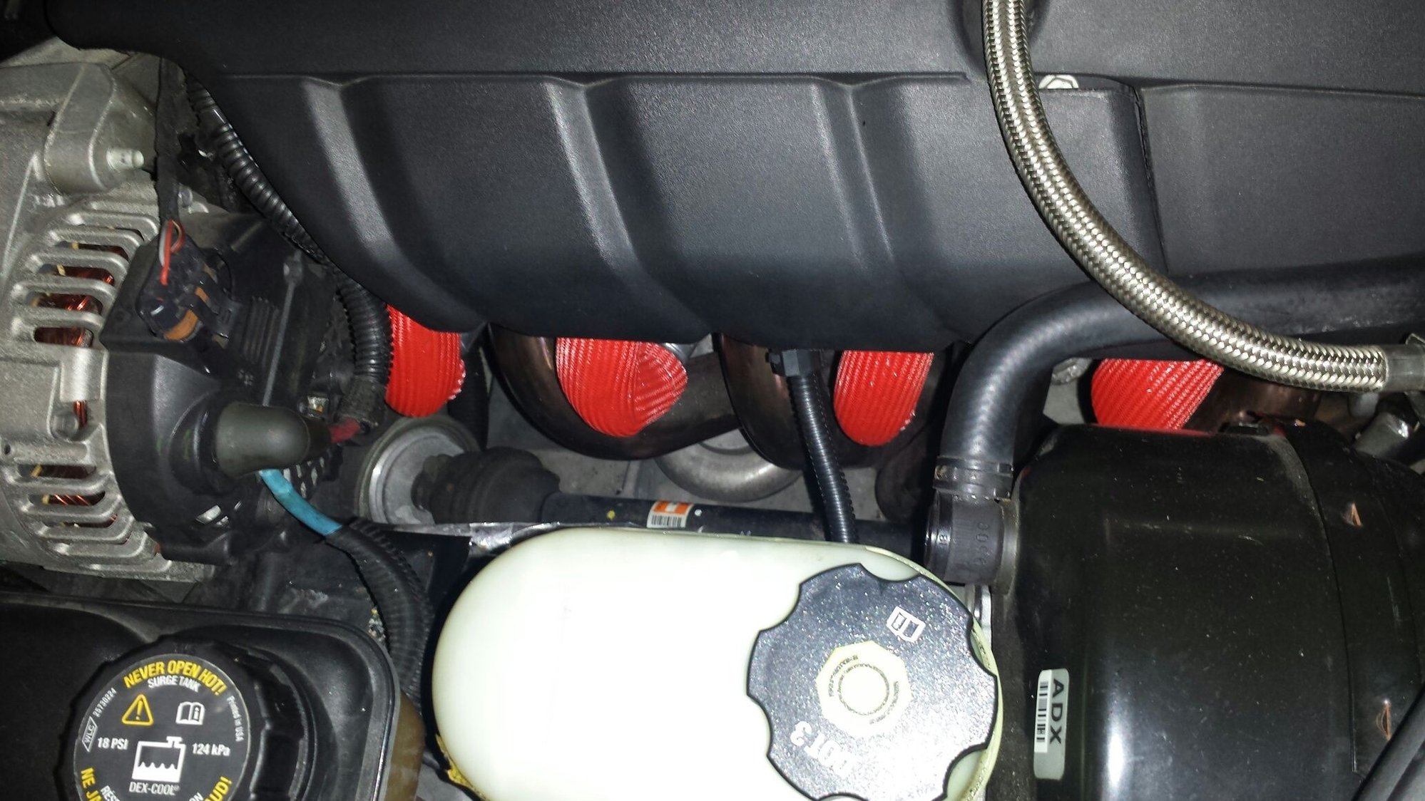

Not sure why or what they are selling , I removed my metal shields, cleaned them up then slid the sock down over the wire down to the metal shield ....

I have stock wires on both my vehicles and reused the metal sleeve with the heat protector socks.
The only thing I can think of is if you want the socks to cover the metal sleeve, you'll have to cut and remove the metal ring inside the socks. That's kind of redundant though since the metal sleeve protects plenty. I won't speak badly about the vendor because I wasn't part of the conversation and they always have good prices/sales. But....they're still in business to make money, which doesn't always translate to accurate advice.

The sleeves won't fit over the ends of stock wires unless you get the oversized sleeves...
I don't have headers, but I hated those stock metal insulaters around the plug boots, I removed the metal sleeves and replaced them with these from Auto zone...I bought 4 regular sized sleeves and cut them in half, then pushed them onto the wire from the bottom, then put the plug wire back on.This has to be better insulation then the metal sleeves......WW
