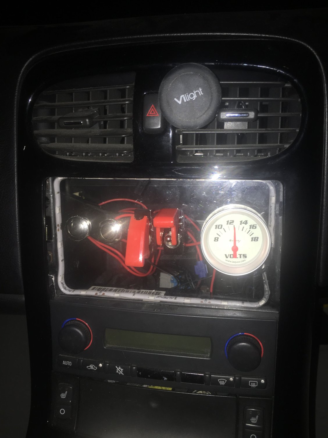

About a month ago I decided to park my vette and make some pretty big changes. So I figured I would share what all I've done.

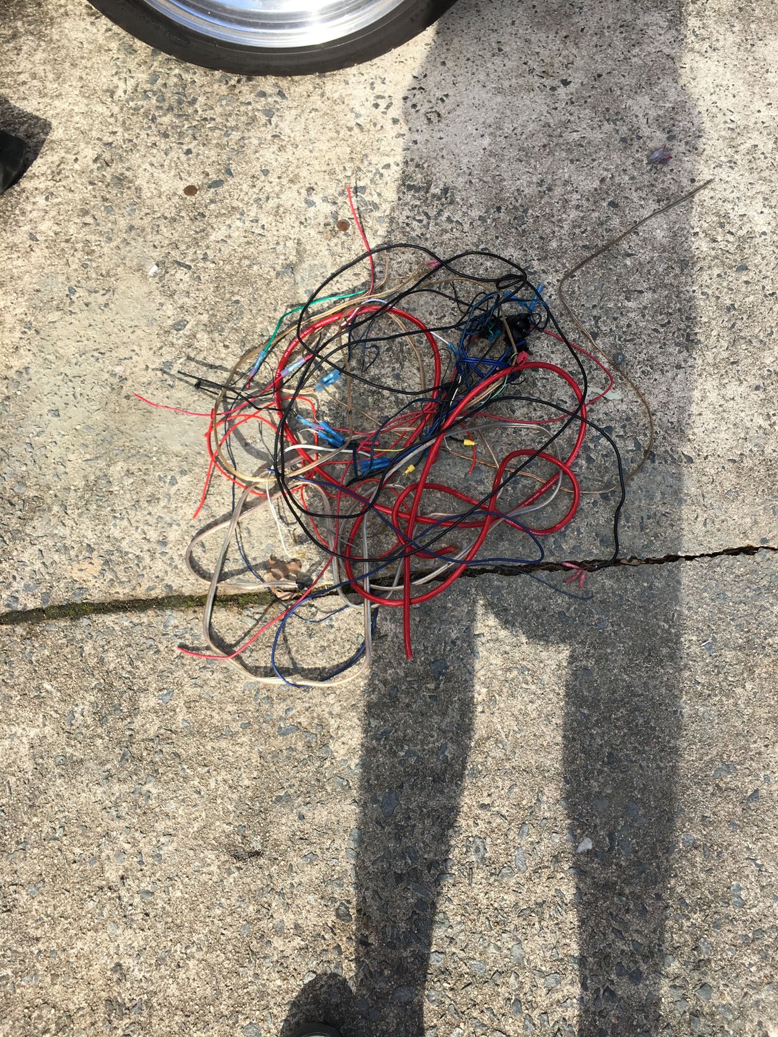

So first off I wanted to strip some weight out of the car, keep it decently comfortable but much lighter. I took all the carpet out and the floor matts. Removed the radio and all the speakers. I filled in the hole where the radio came out with a switch pannel I made. I didn't even listen to the radio anyways and the previous owner butchered wires with an aftermarket system that sounded like **** anyways. So I cleaned up 7miles of random cut wires that led to no where. I also removed the stock seats because they are extremely heavy. I replaced them with 2 NRG racing seats which weigh about 20lbs each.

Nice weight loss..
But due to the brightness of exposed LEDS and night driving issues, i would take that switch panel and hit it with 1000 grit paper on the back side. This would convert the panel to a diffused panel but still have a solid glow. I have done this to many project and custom panels in the past.

that's a good idea I might do that.. I have them on a switch so I usually don't have them on a night it's basically a "cabin light"
