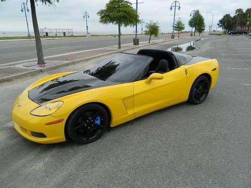

It would be nice to know more about the car...year, miles...stock wheels or aftermarket etc.
It's a 2005 with 80k miles. I believe the wheels are stock, but I'm not positive. Idk if you can tell from the pic

Stock 05 wheels were either chrome or polished. No black.
