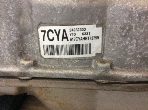

Here are some pics to show you...All are 6-speed C6 corvette automatic transmissions.

I hope you understand the C6 transmission is totally electronically controlled and the paddle switches use resistors to apply different currents on a single input. I have the wiring diagrams if you need them.
