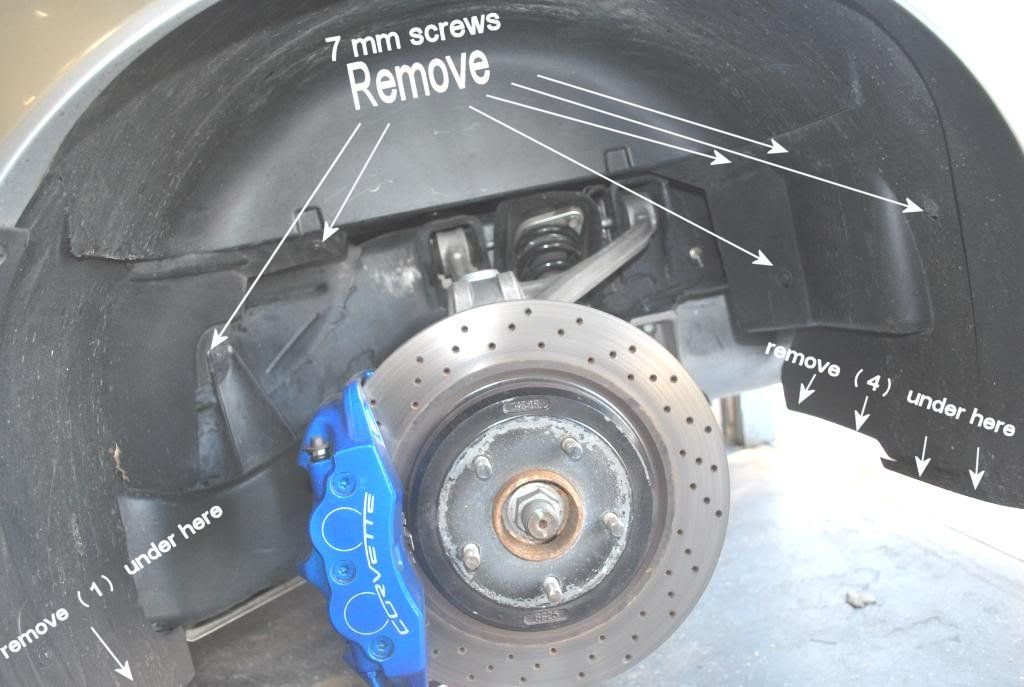

If you remove the rear wheel liners, you will then see the cavity in the front of the wheels and the bag of insulation (wrapped in black plastic) put there from the factory.
As mentioned, with the rear liners removed, you can install Noico type material above the liner, on the metal/plastic panels in that cavity, and put more bagged insulation to fully engulf that cavity to try to prevent as much tire noise sound travel as possible from outside to inside the vehicle.
There is no end to how much you can use, but as mentioned, the noise will never be completely eraticated.
Here is a pic to remove the rear wheel liner.
good info...thanks
