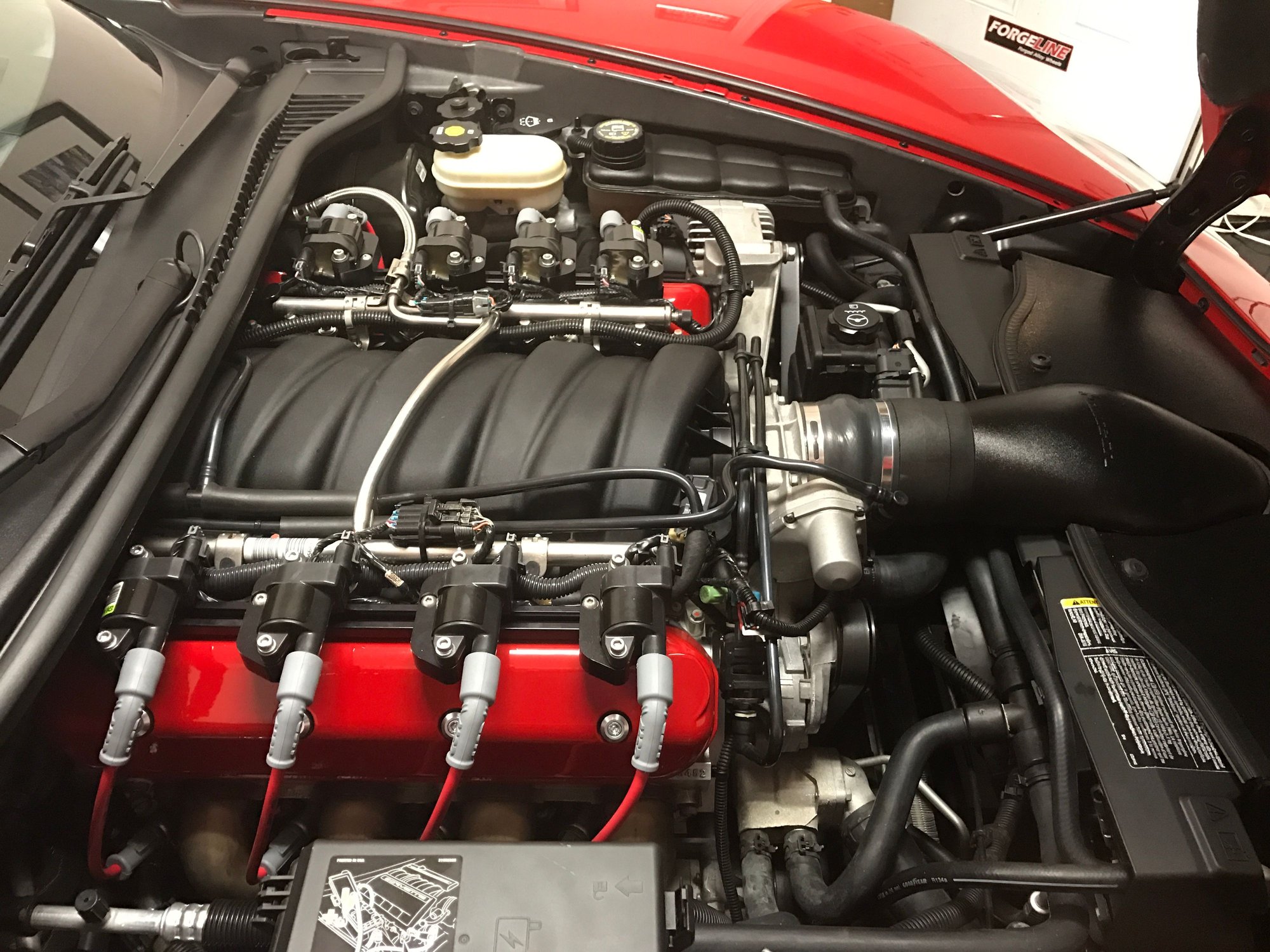

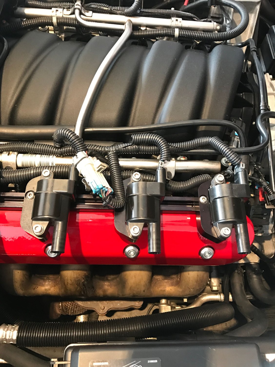

Hey guys,
I installed the katech coil relocation kit in my z-06. Is there any problem with the coil connector (the big white one) laying on the fuel rails? I have seen many stick the connector between two coils which i did the first time and tried covering the wires with wire covers (see first pic). I did not like the look. So then, I ran the wires under the fuel line, painted the white connector black, and moved it up and away from the coils (see second pic). I like this look a lot better. But is there any problem with it laying up on the lines? I know they can get hot, but everything under the engine bay is hot. thoughts??

I actually have them zip tied to the fuel rails.
Just wondering if that will get too hot

Not going to get as hot as when it was ran through the stock valve cover bracket and covered up under the FRC's.

Plus, the fuel rails, having a constant flow of fresh cold fuel flowing through them are probably one of the colder places under the hood and at most running moments - RELATIVELY speaking. That connector is made to withstand more heat than what the fuel rail can generate.

Thanks guys! That makes me feel a lot better. I took it out for a quick drive and the fuel rails were pretty hot and that's what got me a little worried. Everything looked good after a 20 min drive. I just didn't want to damage anything if I took a long trip.
