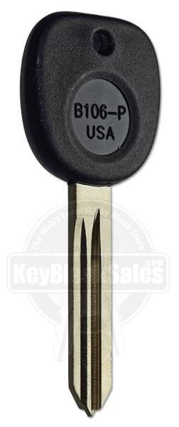

Anybody have a part # for the trunk key. 2005
Old Mar 7, 2017 | 08:07 PM
cclive's Avatar
cclive
Joined: Mar 2008
Posts: 21,502
Likes: 461
From: Southern Utah
It's a B-106 key blank...any good lock shop will have it but only the dealer can cut it based on the VIN...a lock shop can only copy an existing key.
Old Mar 7, 2017 | 09:00 PM
Slick Rick's Avatar
Slick Rick
Joined: Apr 2007
Posts: 650
From: Pittsburg Ca.
Thanks I found one on e-bay. But I do have one more question. I go out start the car hit my option buttons to see if it locates the fob I have and I get options unavailable in my dic. Im assuming after I get a key cut and can do the five turns and put the new fob in to program it this will go away and I will have options for my fob.... Am I correct to think this....
