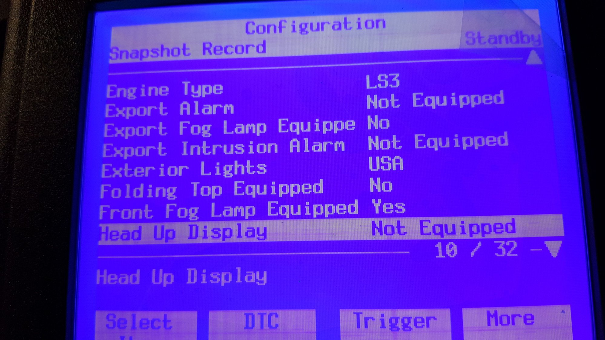

WW7 , So far I have not needed to use the disks on my 2011 , thank god because you need a windows XP machine , I can get into the ECM , BCM , ANTI LOCK brakes ETC ETC parameters and change them ( be careful while you are learning ....... )
I have already been into my ECM chasing a random miss
Below is a snap shot of my BCM configuration file , if you go one menu back from this screen you can modify the setup and turn things on and off ( look at my HUD setting )
Dave
