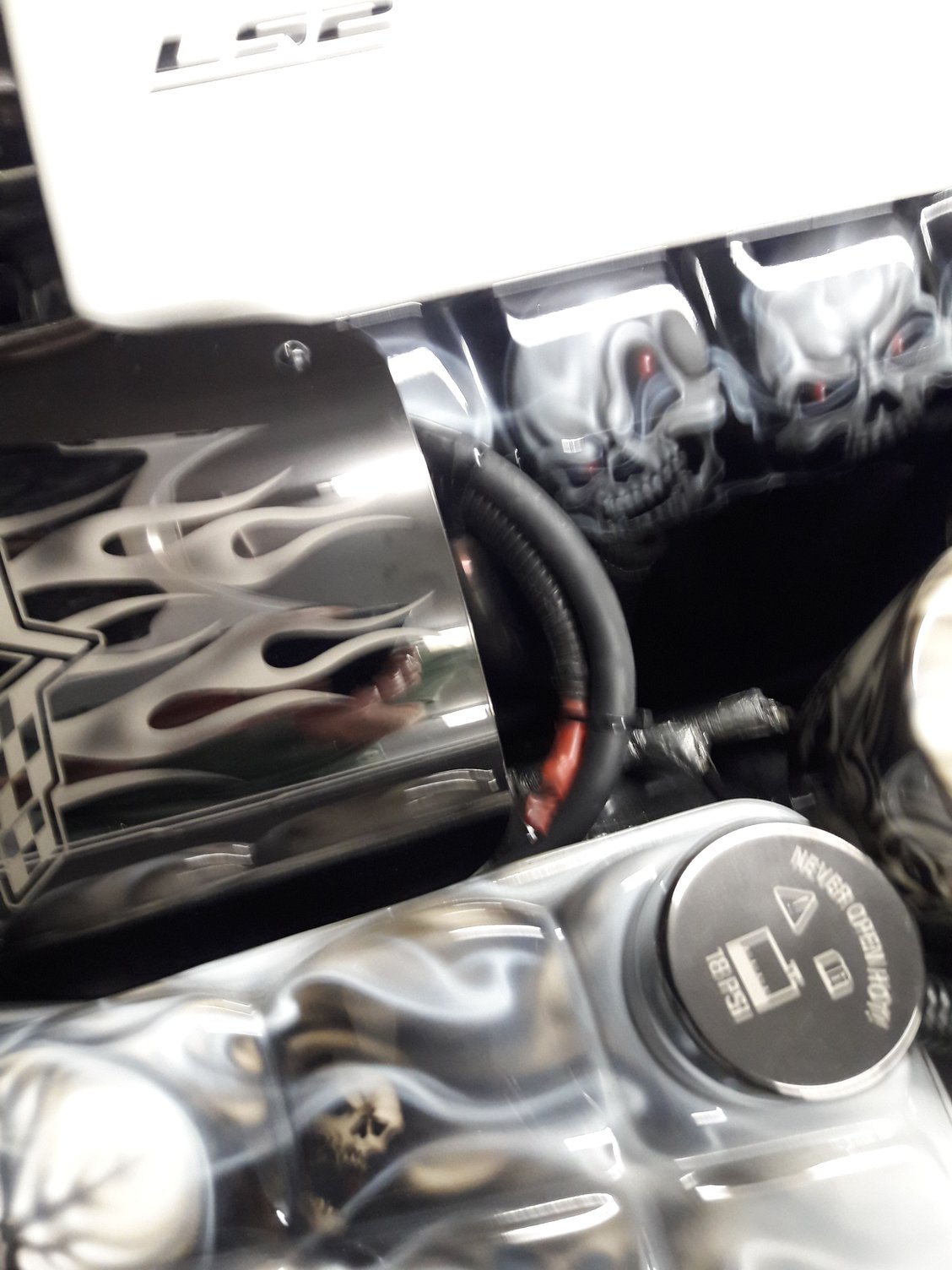

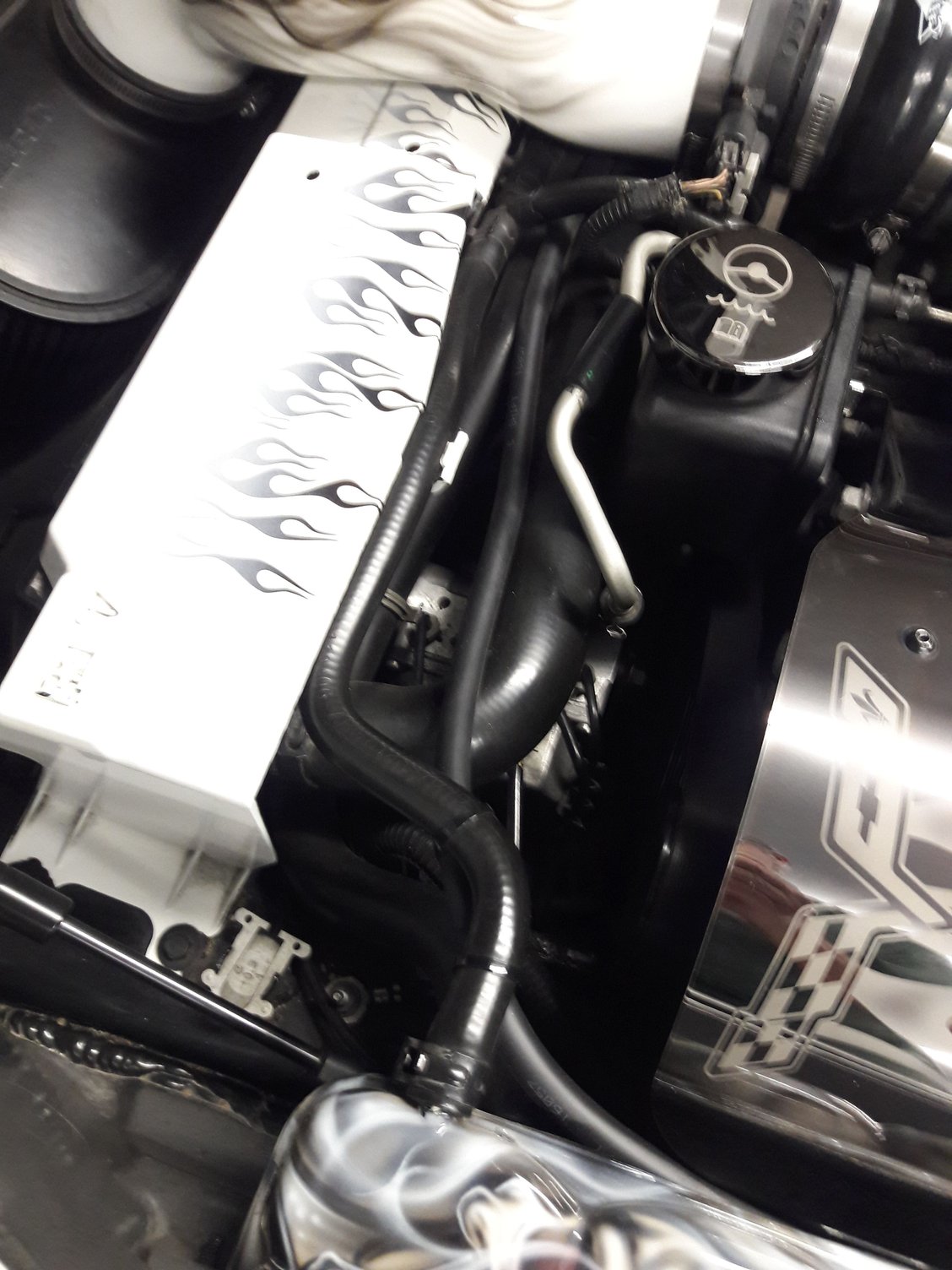

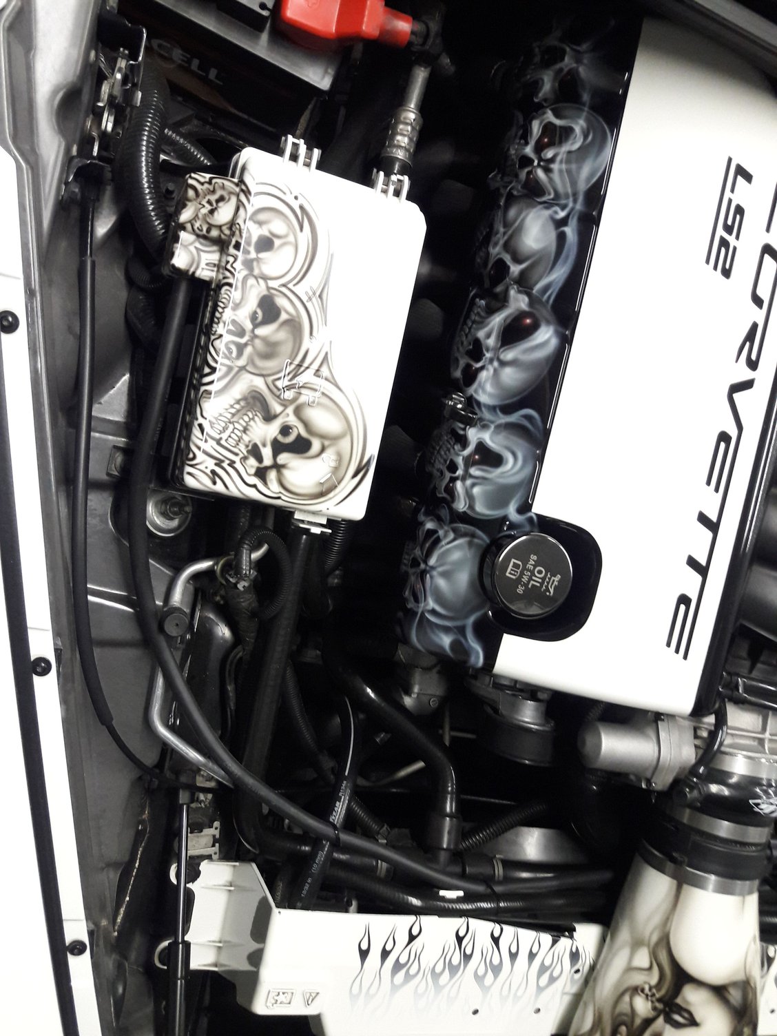

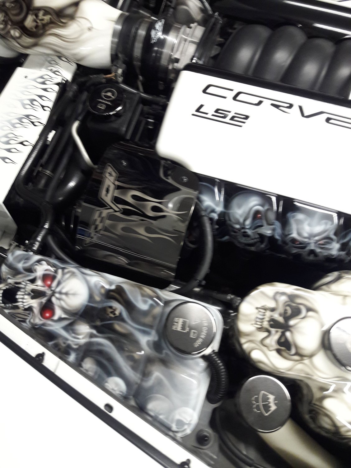

Ran it along the heater hoses under the air bridge. You probably would not notice it. Got it from Orielly pre made with heavy duty ends. Used zip ties to secure it.
http://m.oreillyauto.com/h5/r/oap/si...0358&ppt=C0005
Here is the old one tied to the new bigger one. I pulled it out so you could see it.
Here it is hidden again.
Here is where I connected to the car. Cut out some of the fuse box lid so it shuts over the new cable.
