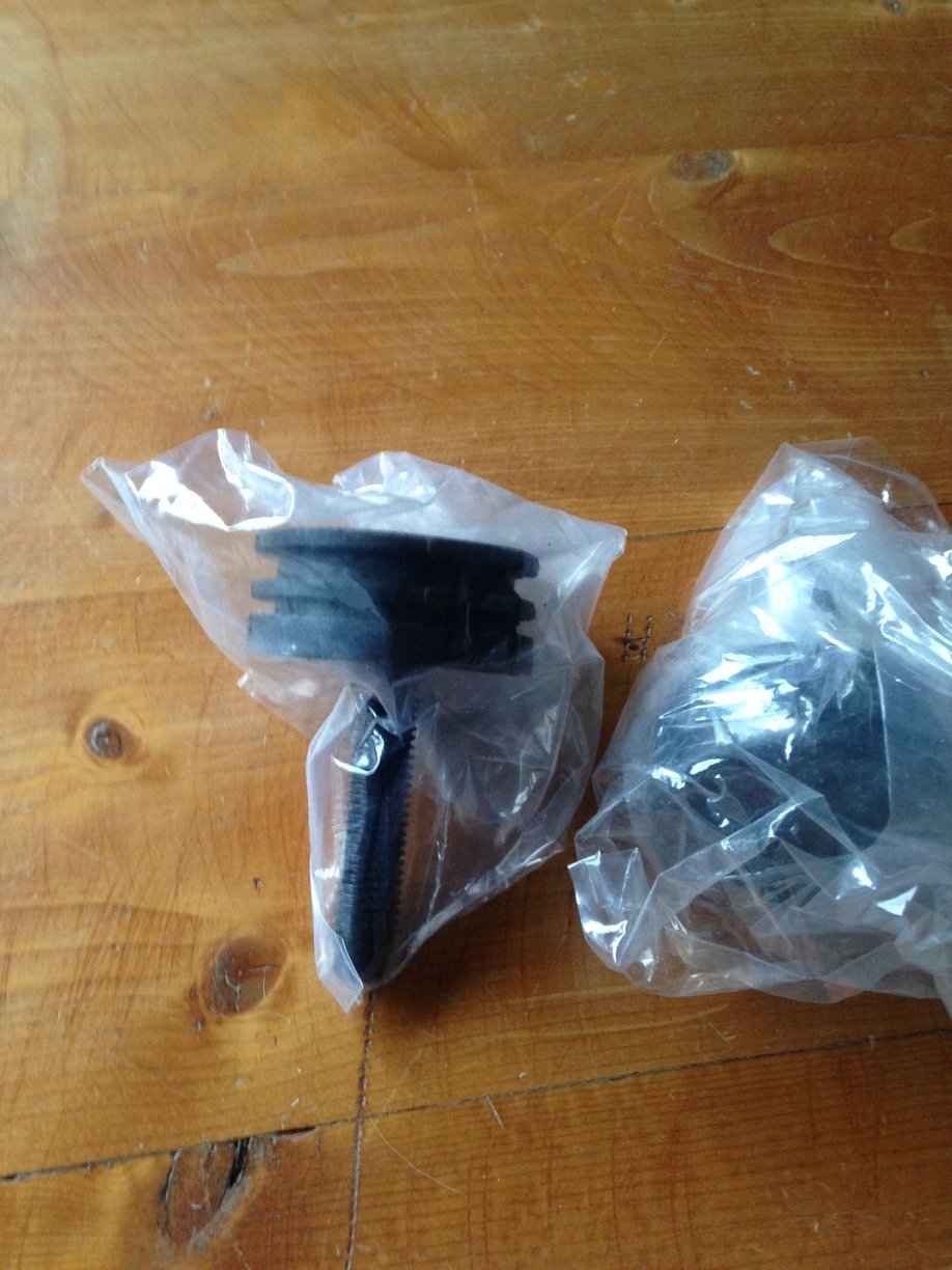

Shocks on a stock suspension C6 bear no weight of the car. All the weight both front and back is carried by a front and rear leaf spring. Each spring has adjustment screws on each end that control ride height. These adjustment screws have 1" of rubber pad that gets worn down and disintegrates over time. Over time, the ride height will always lower unless adjusted at the time of a wheel alignment.
Pic of a new set and pic of a worn one:

Thanks blindspot, I will check into this. I had the car up on a lift today and did not see anything physically wrong with the shocks or springs. Probably just needs an ride height adjustment and possibly the adjustment screws you are referencing.

Curious, How many miles are on the worn out adjusters?

the pic of the worn one I just googled an image. Actually that one was on ebay seller was selling a leaf spring and calling that adjuster good. I have seen them completely worn down to the metal plate. Hard to relate to miles but more how hard driven. Also simply an age issue with rubber drying out over time. The entire weight of the car rests on these 4 screws.
