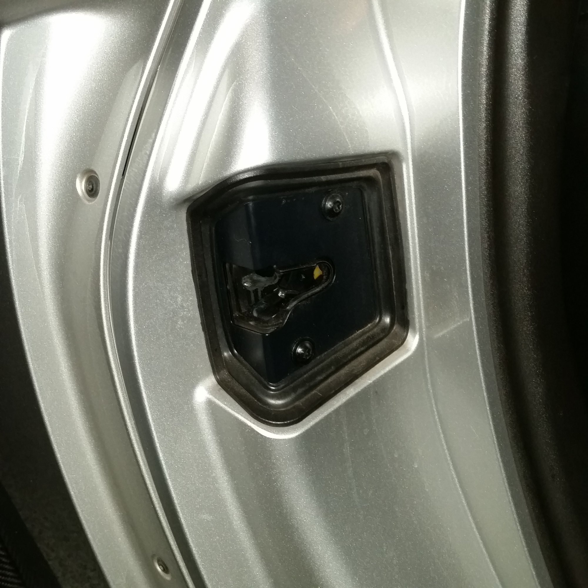

Old May 8, 2017 | 08:07 PM
EVRose's Avatar
EVRose
Joined: Oct 2010
Posts: 14,475
Likes: 785
From: Las Vegas NV
Originally Posted by DDP
Is that the DIY one that I see on the forum?
Actually I was referring to this. Spray some liquid wrench or use some grease on it.
Old May 8, 2017 | 08:31 PM
DDP's Avatar
DDP
Joined: Apr 2012
Posts: 1,256
Likes: 90
From: Woodbridge Ontario
OK I'll try that, I did the other DIY I figured what the hell.
Old May 8, 2017 | 08:46 PM
DDP's Avatar
DDP
Joined: Apr 2012
Posts: 1,256
Likes: 90
Well I greased it as EVRose suggested and still have to use the cable to open the door, I guess I'm buying a new latch tomorrow
