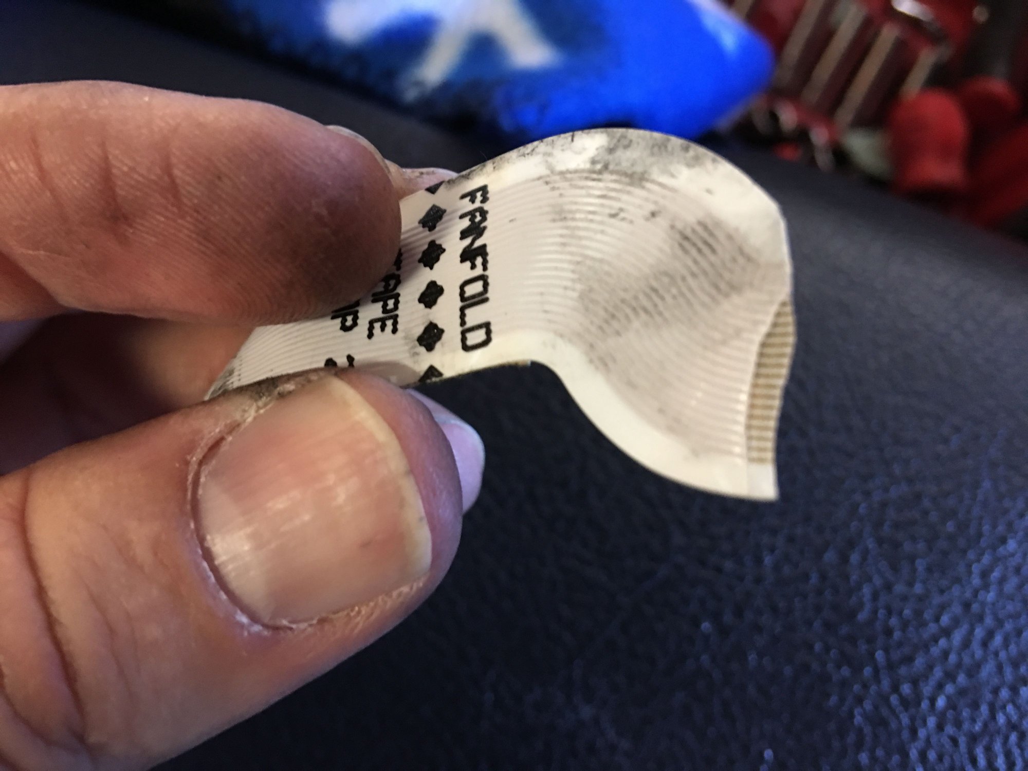

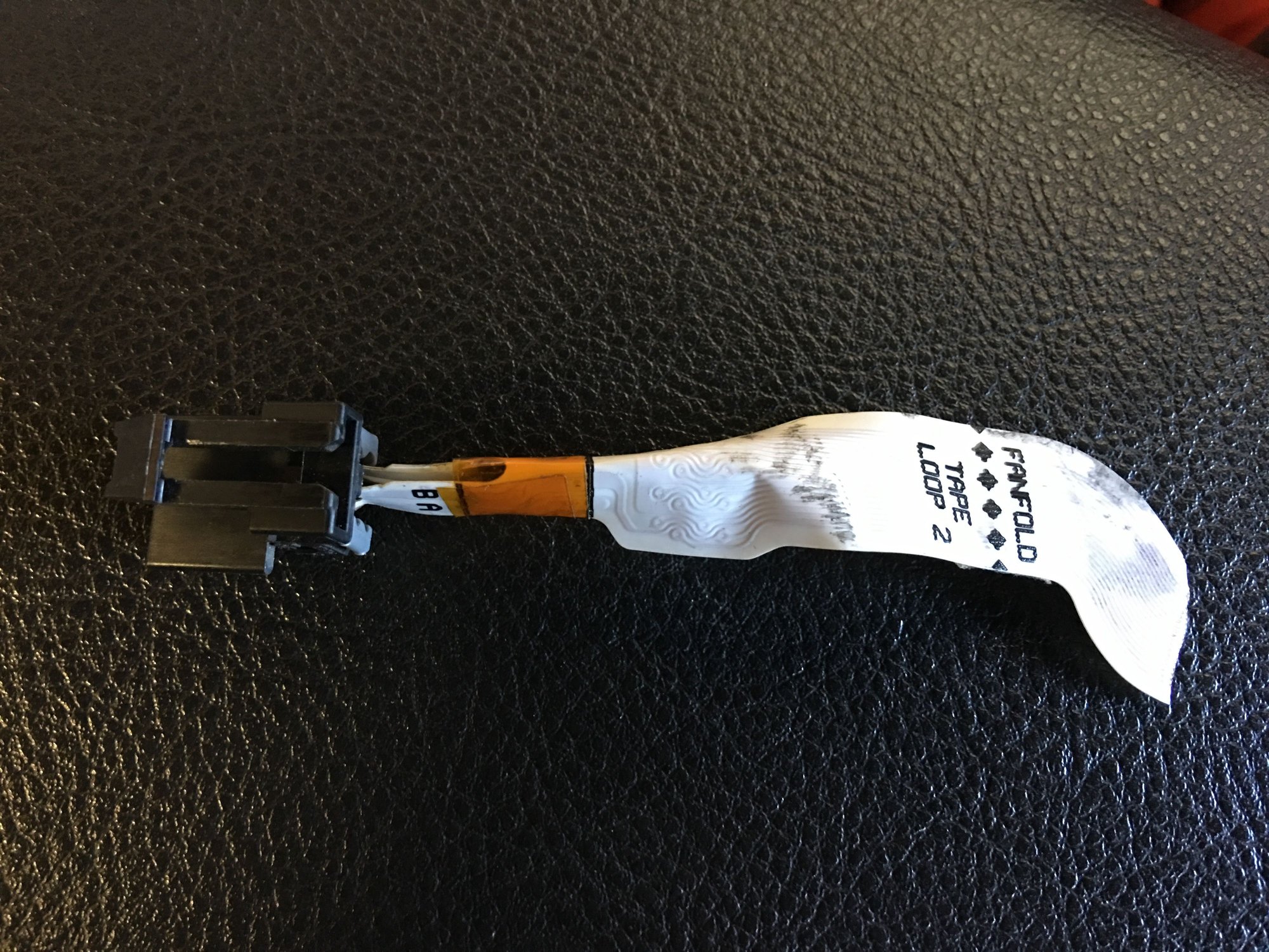

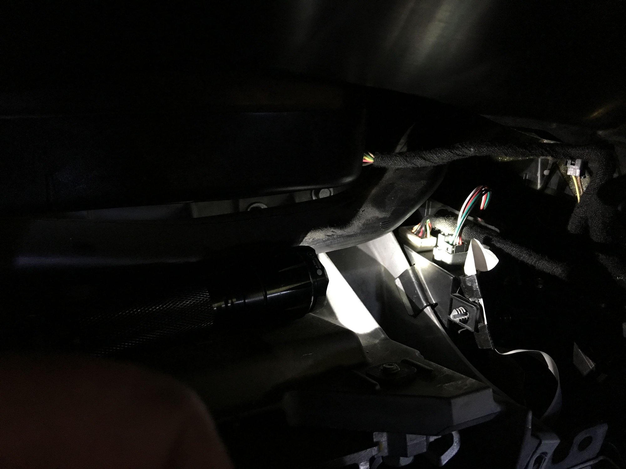

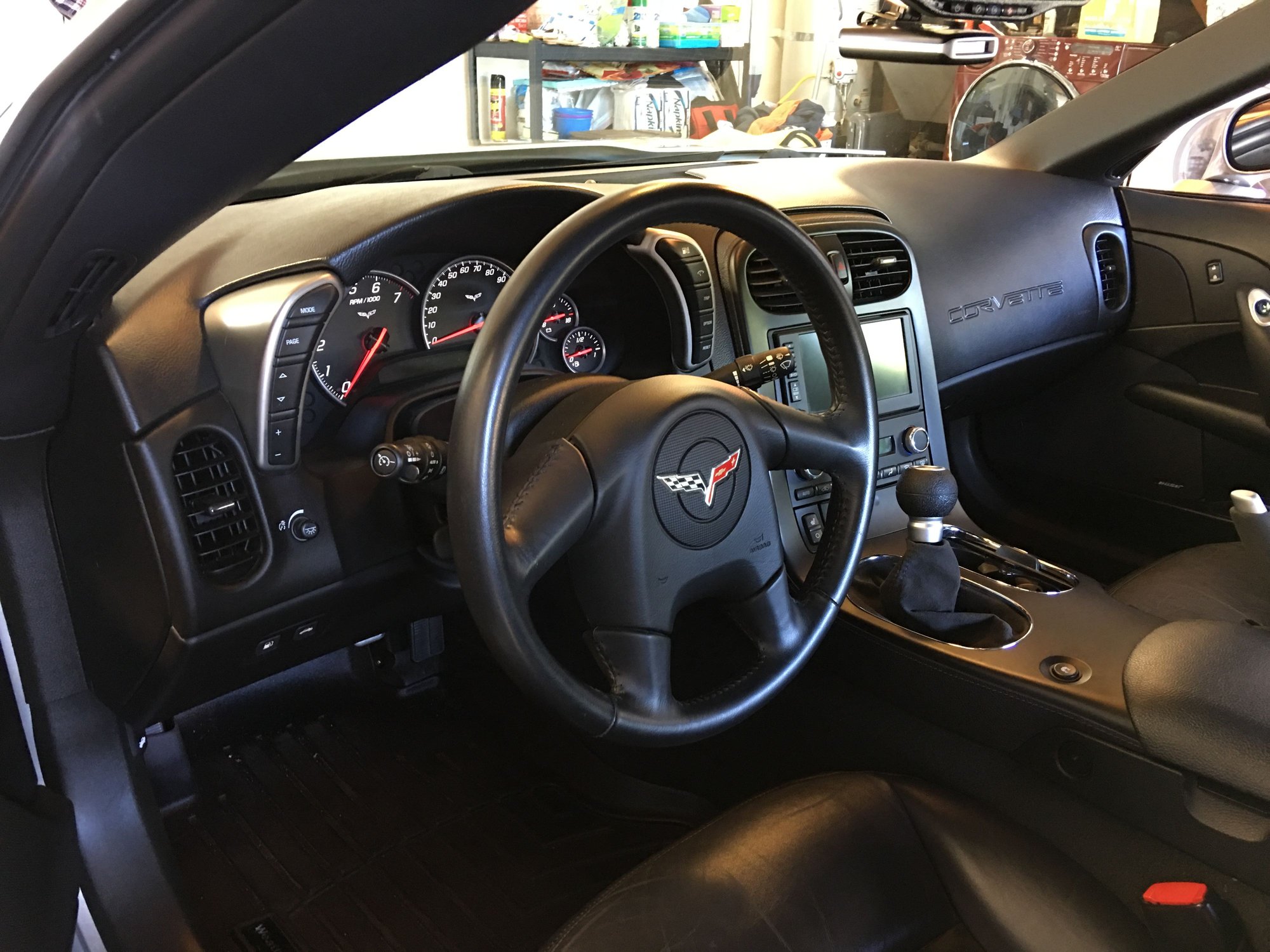

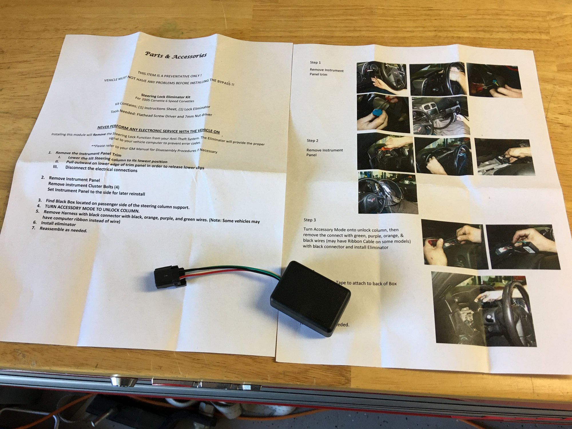

If you own a 2005 manuel C6 this modification is a must. I've own this C6 for two years without an issue but the dreaded service column lock came out of nowhere. So I decided to install a column lock bypass from ebay (WW7 posted a link if your interested). This a great little product and couldn't be happier with the results. Here are a few pictures of my install and youtube install video, these guys make it look simple which it is but those damn clips are a PITA!
Column Lock Bypass.
Before my install pic
These two clips are a PITA!
Out with the old column lock wiring harness.
Bypass installed.
This ribbon was fragile as hell and broke on me! No biggie.
Close up shot
All put back together.
