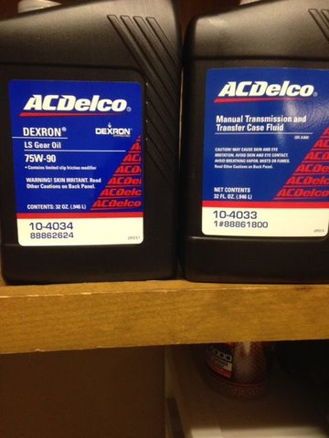

Differential fluid on the left; manual trans fluid on the right. Suggest you stay away from anything that says "DEX III compatible" and use only this REAL DEX III. Amazon sells both and prob the best deal.

BTW - it can become confusing if you're "searching" the forum for additional info. The DIFF fluid is COMPLETE as pictured and needs NO modifiers. Older versions DID require a friction modifier, this one does not.
