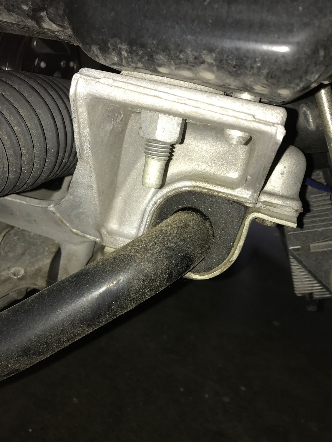

I guess I just get it on a lift and pull on the sway bar? I found this too

I got it on the lift this morning and everything looked ok. No play in the sway bar links nor did the bushings look worn. The sway bar bushing wasn't fully seated in the bracket so I fixed that and drove it around and nothing. Turned in my drive way and left wheel first and as I started to straighten it out I heard it again. I'm kind of at a loss on this one. It only does it on slow bumps turning right.
