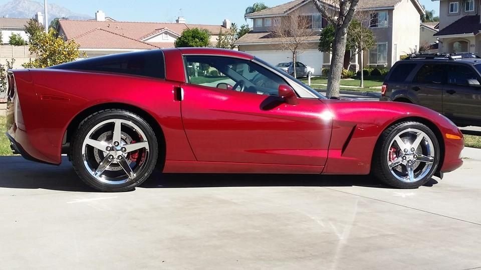

They look like stock GM 5 spokes except you have different center caps. They have nothing to do with the Z51 package
This is the stock polished aluminum 5 spoke on my 2007.

Holy Crap, yours look awesome!!!!! How did you get them so shiny, especially since they are clear coated from the factory, and don't look anywhere that good when new?

Thank you!
I treat them the same as the rest of the clear coated paint on my car. Clay, polish, wax.
I think a lot of people use wheel cleaners, chrome polish, aluminum polish, etc. These wheels have a clear coat on them and that clear coat should be treated like any other clear coat. Anybody with polished aluminum wheels should dump all of the wheel specialty products on their shelves and stop damaging that clear coat.

They sure do look like chrome to me.

I had one guy here pm me a couple of times insisting they were chrome. First thing I did when I bought the car was to check the code in the glove box to see what I was dealing with because the wheels pretty dull (similar to OP on this thread). Brought out the polish and the Porter Cable and went to work. Finished them off with Rejex and they have looked like this for over three years.

Did you buy the car new,? If not how did you determine that the wheels were not replaced with chrome wheels?
No offence to your polishing expertise.

Check the RPO code in your glove box. Mine are painted too. That is the whole point. They are polished and then painted with a clear coat of paint, just like the rest of the car. That clear coat is often ruined by people using wheel cleaners on them and messing up the clear coat of paint that protects the polished aluminum. My wheels looked liked yours when I bought my car.
If your RPO code says you have polished aluminum wheels (very possible), that shine is available with a little elbow grease.
