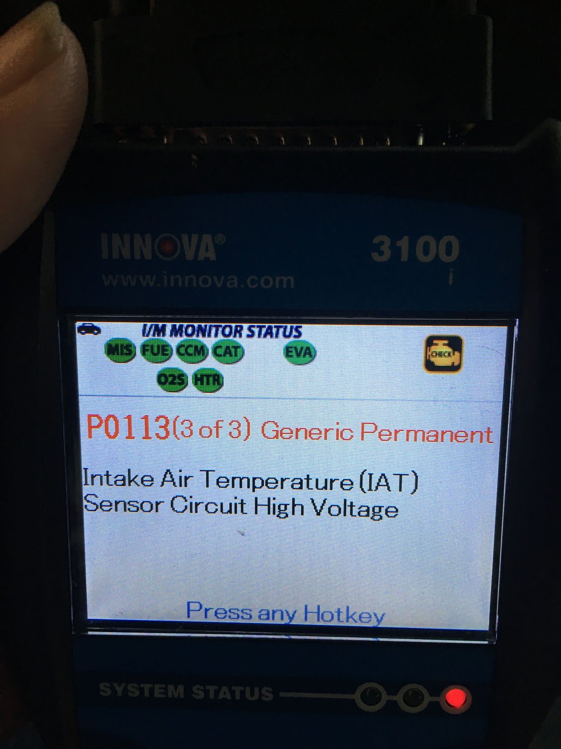

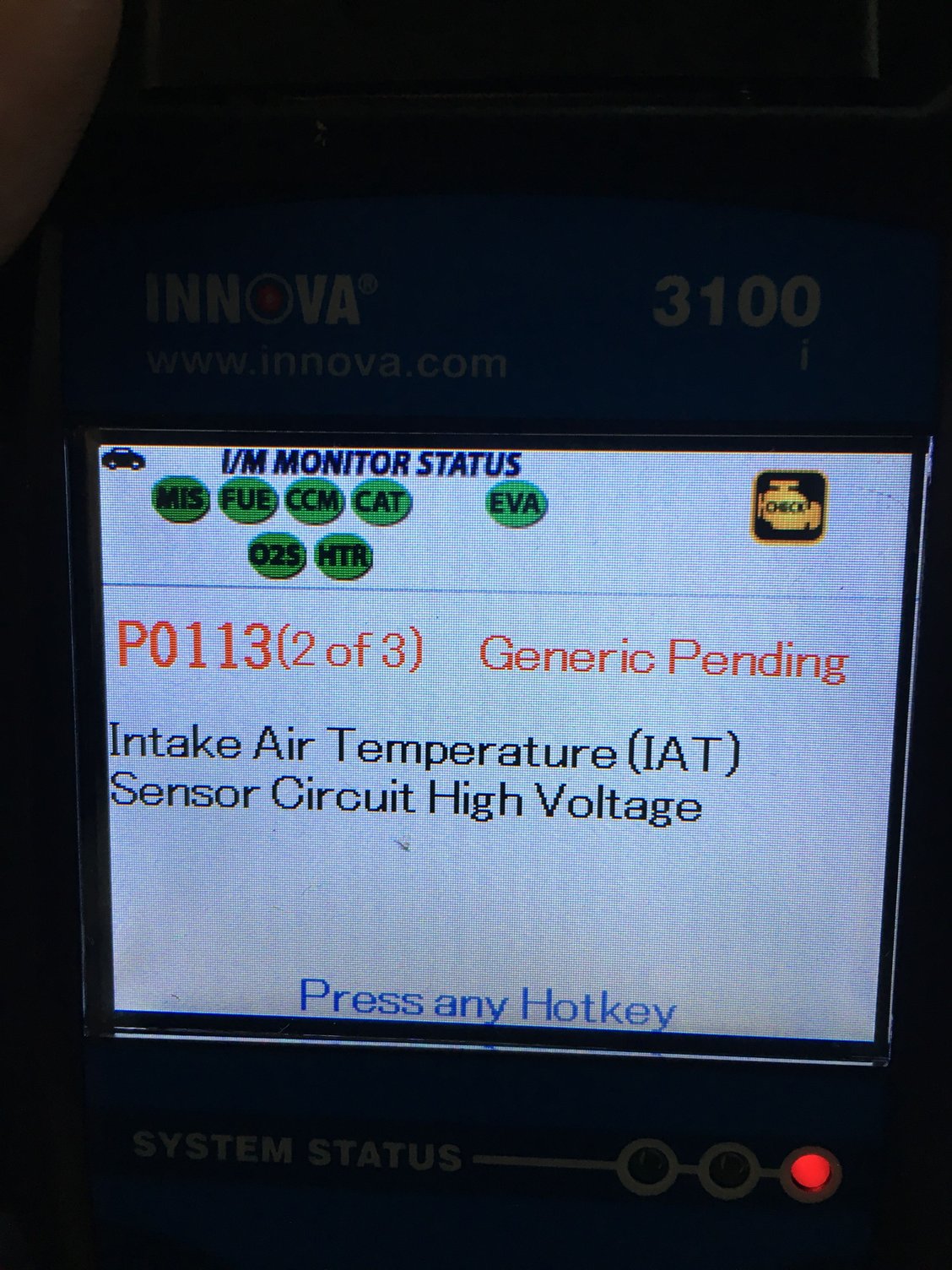

So, you're receiving (and have received in the past) an IAT failure. The IAT on an LS3 is built into the MAF. Essentially, the voltage signal getting back to the ECM is out of range and appears to be intermittent. This could be happening for two reasons:
1. The IAT side of the MAF sensor has failed (or is failing intermittently) or
2. The MAF is dirty (look up how to properly clean a MAF).
As a distant possible 3rd, check the harness and connector to the MAF and check the rubber seal around the MAF is in place.
An IAT out of range isn't going to put you in limp mode, but when the ECM cannot reconcile the intake temp, it will default to a safe spark timing. When it pulls ign. timing you'll lose optimal power if P0113 is active at WOT.

BTW Hwyknight, I omitted but should have added:
First step, clear the codes active and history, start the car and observe the dash, see if/when a CEL is reset. If it takes some driving to get the CEL to reset, or if it takes a certain speed or certain outside air temp, these all can be valuable observations in diagnosis. These conditions would indicate an IAT sensor that is failing at a given point or temp. Here is where cleaning might help, an intermittent cable failure, or the MAF sensor might need replacement.
If, on the other hand, the CEL sets immediately, then more indicates a hard failure, but cleaning might still work. I like doing observations like these and only want to replace a part as a last resort.

I'm convinced there may be some ghost in the machine. Cleared th codes, and stared it up; CEL stayed on, and service TC & AH warnings popped up. Drove it a mile or two, pulled over, shutdown, and cleared the codes again. Restart and all warnings gone. I'll just drive it a bit and keep an eye on it.
Interesting note, the VIN returned by my code reader doesn't match the car, so I'm guessing that at some point the cars main computer was replaced. Possibly with a used one........or I need to update the software in my code reader......
Don't worry about TC and AH. These are not additional faults, but the ECM disables these two safety features on almost every P-Coded CEL because these features rely on several control parameters coming from the ECM such as ETC, Fuel Cutoff, and others including chassis controls out of the EBCM.
TC and AH are two of the most misunderstood messages and constant threads on CF confirm that. As soon as the CEL issue is fixed and code cleared, TC and AH come back on their own. But, expect to see them every time a new CEL is set.
If the ECM was changed somewhere along the life of this car, whoever installed it would have had to program in the correct VIN to match the EBCM; otherwise, the car wouldn't have started. Probably not that big a concern with a less expensive Scan tool as long as its reading the P-Code faults.
Yes, if you have codes cleared, then as you drive it, note the conditions under which the car is operating if/when it sets again. If P0113 continues to show up, time after time, then you'll likely end up replacing the MAF if you've tried cleaning it already.
