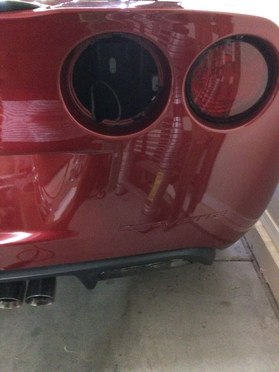

First was the taillight removal. A T-15 torx was all that was needed.

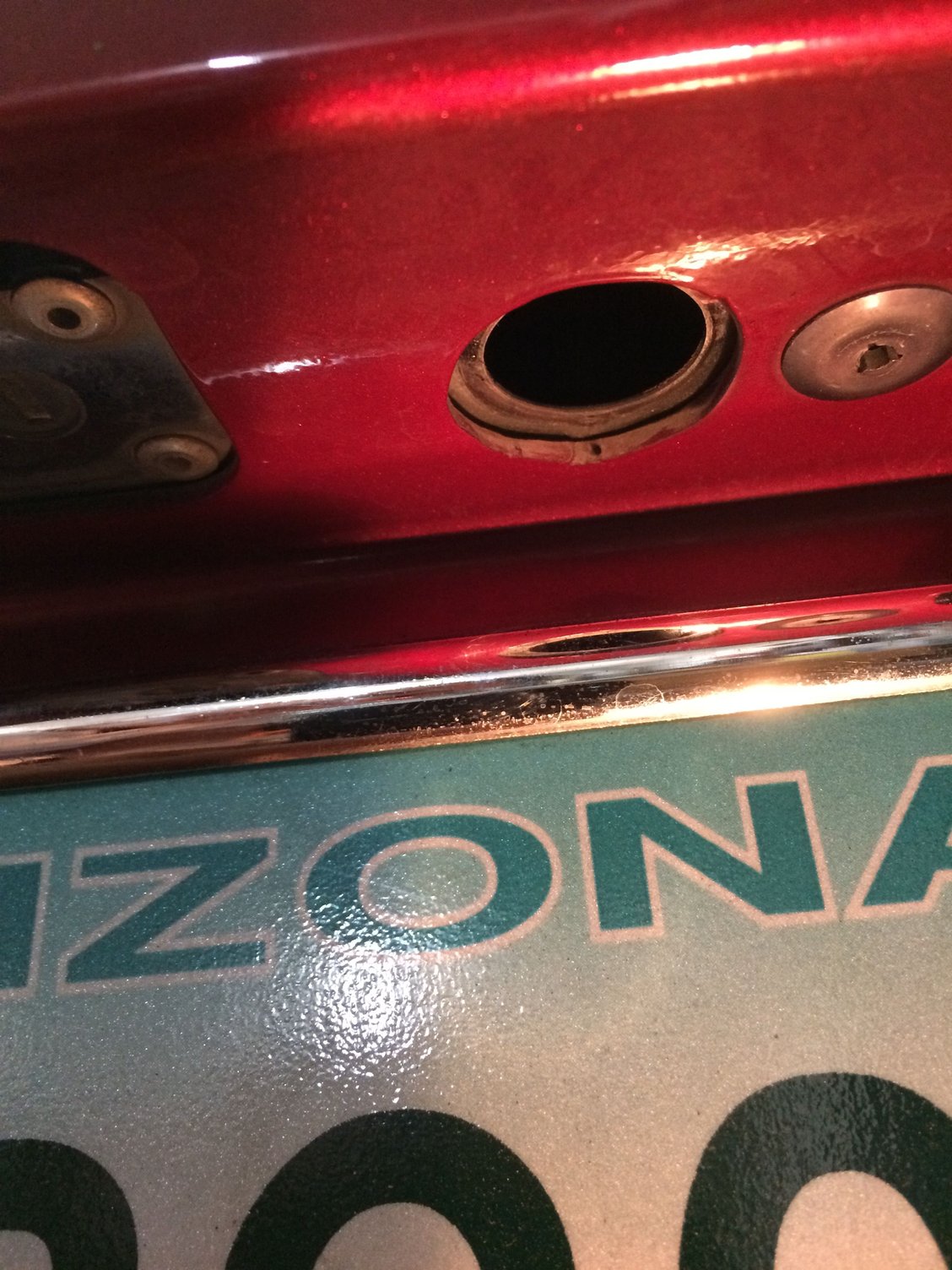

Second was the switch removal. Unplug the electrical plug, pinch the 2 retaining tabs together, and it's out.

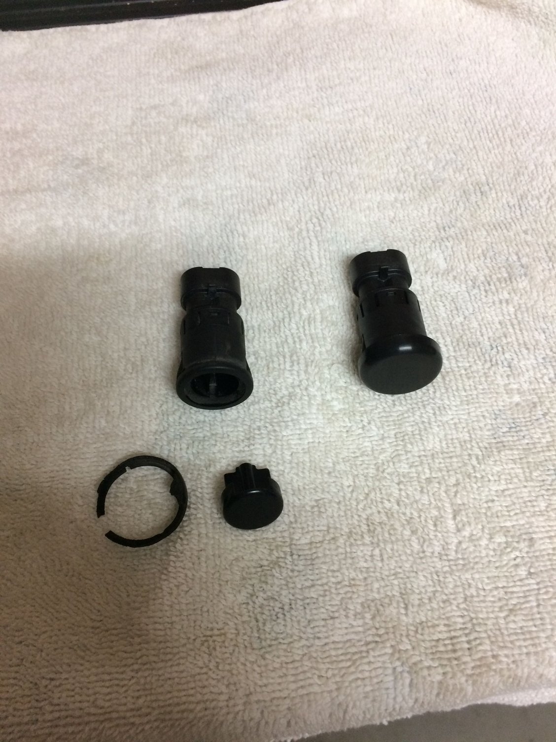

Finally install the new switch in reverse order. Here is a photo of the old switch on the left and new switch on the right. There was nothing wrong with the old switch except the rubber cover wore and deteriorated over time. Without the rubber cover, the push button will not stay in the switch, making it inoperable. And you cannot buy just the rubber cover, you have to buy the entire switch. I got one from Gene at Cultrag.

Thank you. Until the rubber cover just fell off one day, my switch has always worked without any problem. I guess age was the culprit. I also use that switch probably twice as much as the one on the dash, so maybe constant use helped promote it's demise.
