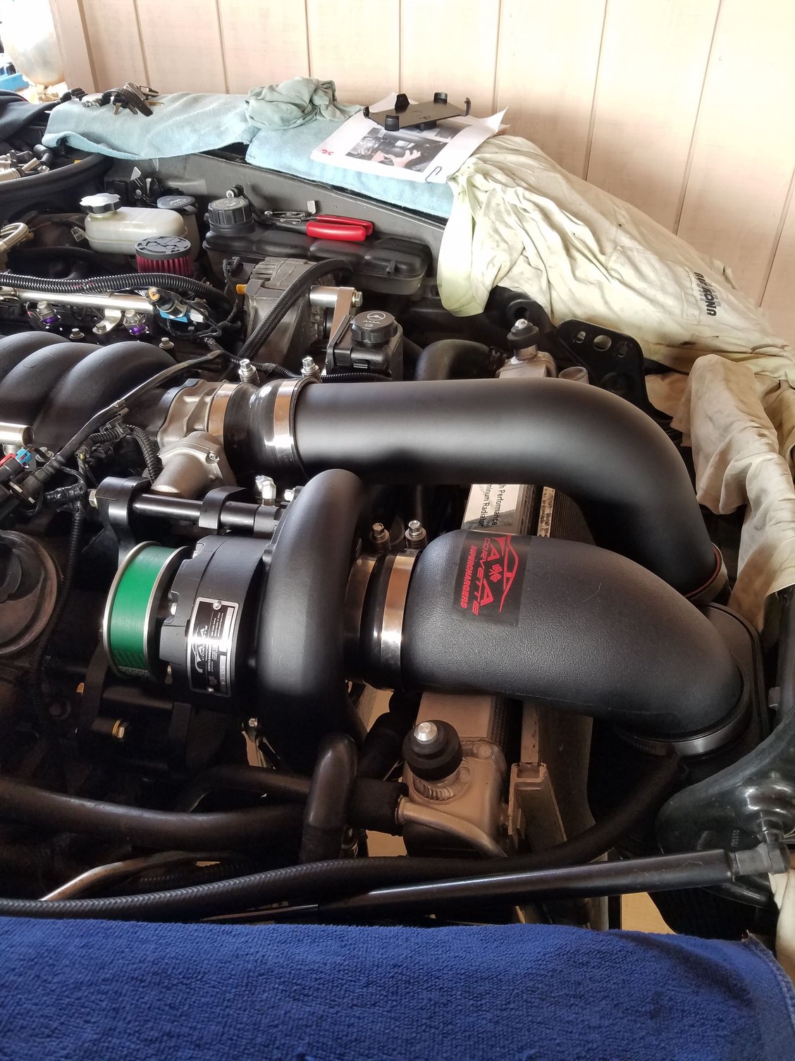

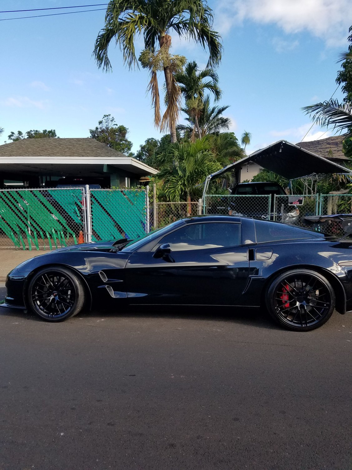

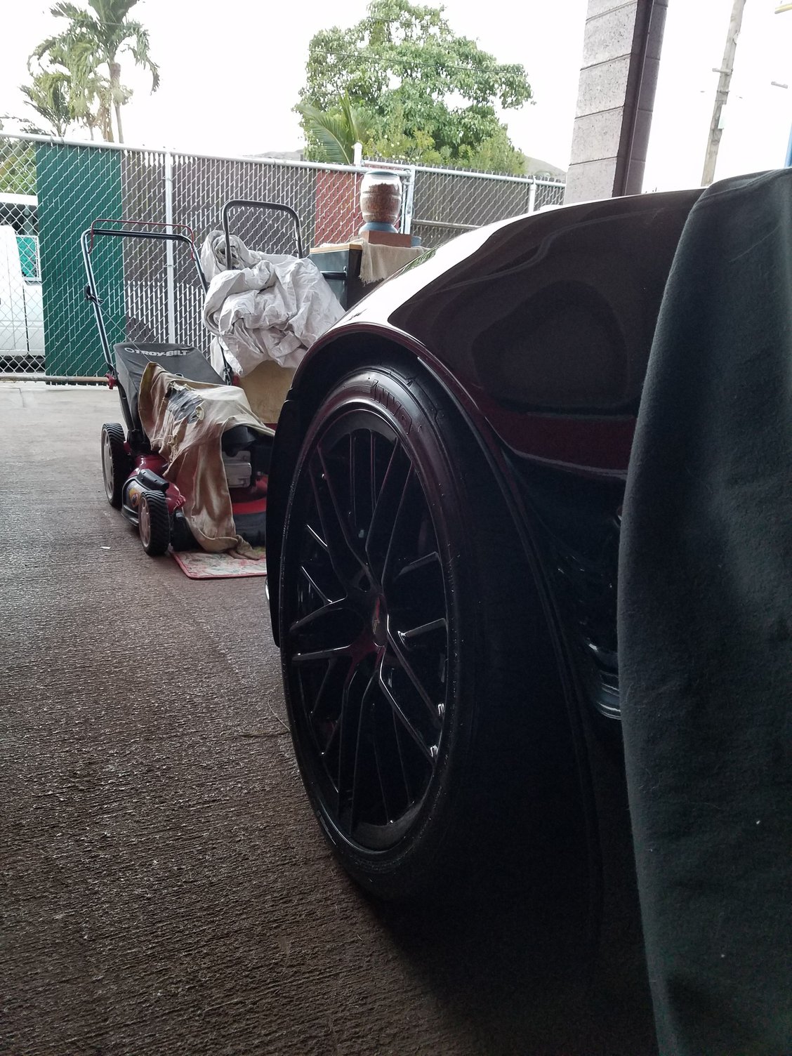

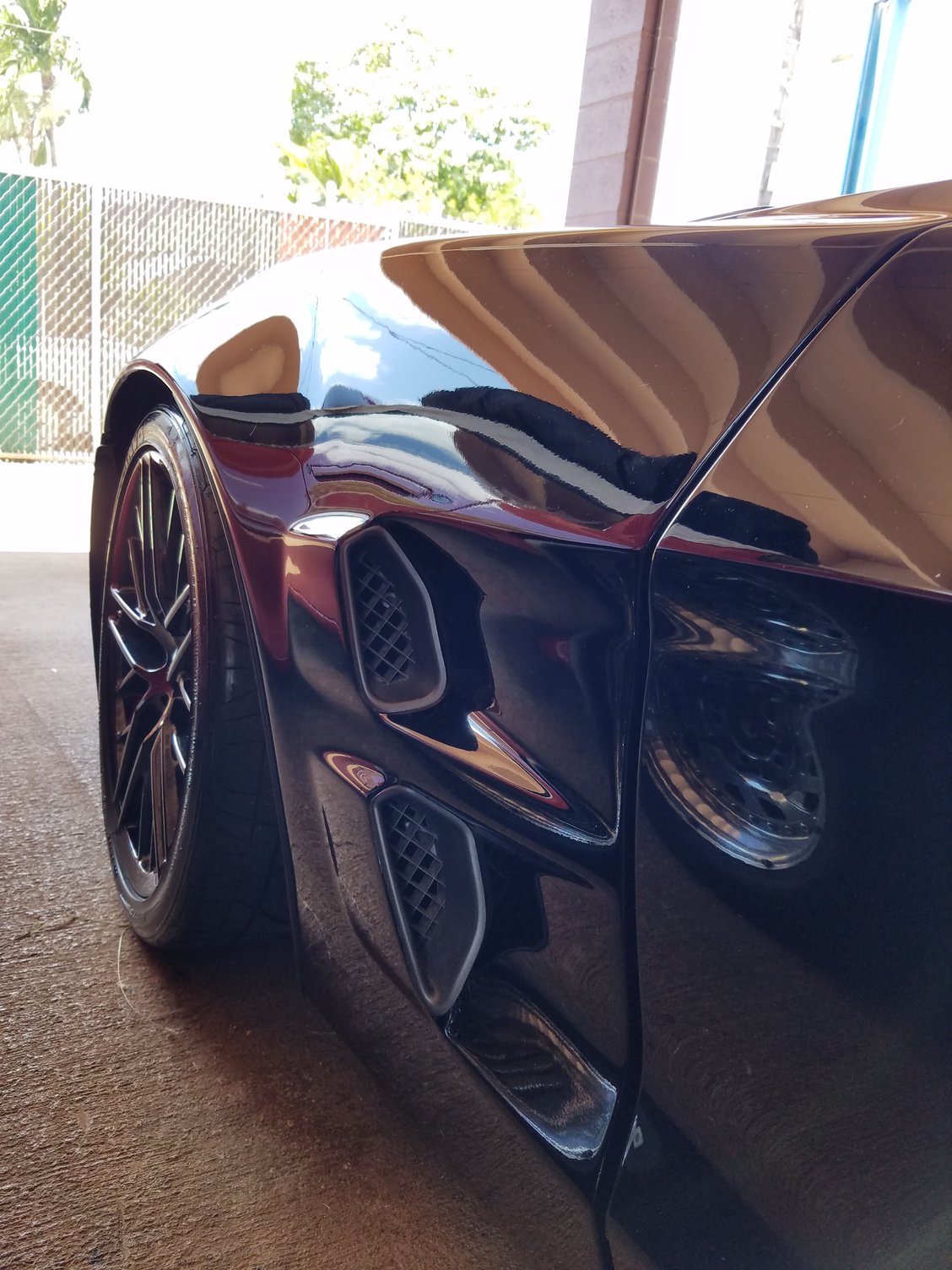

Heres mine.All done.Been there done that.All upgraded everything plus supercharger and carbon fiber pieces.Ilost count how much Ive spent .15k maybe more.LOL.
