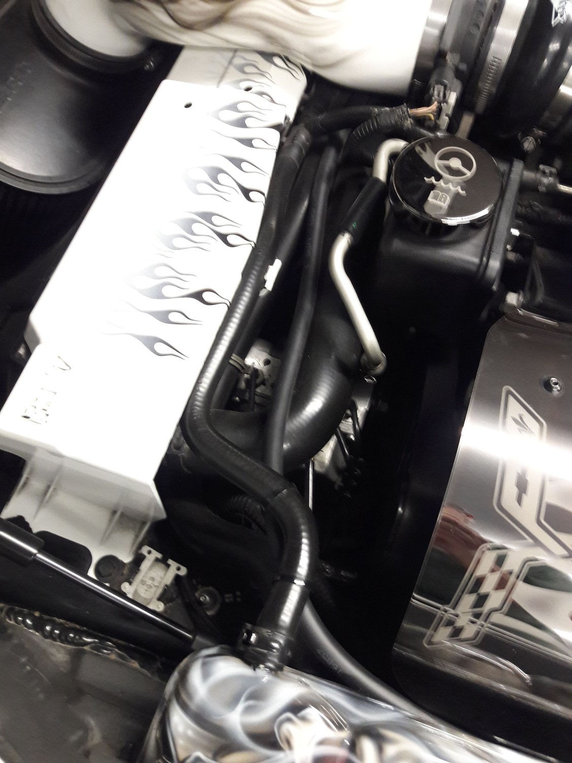

Pic of old cable zip tied under new larger cable. It was pulled out so it could be seen for this pic.

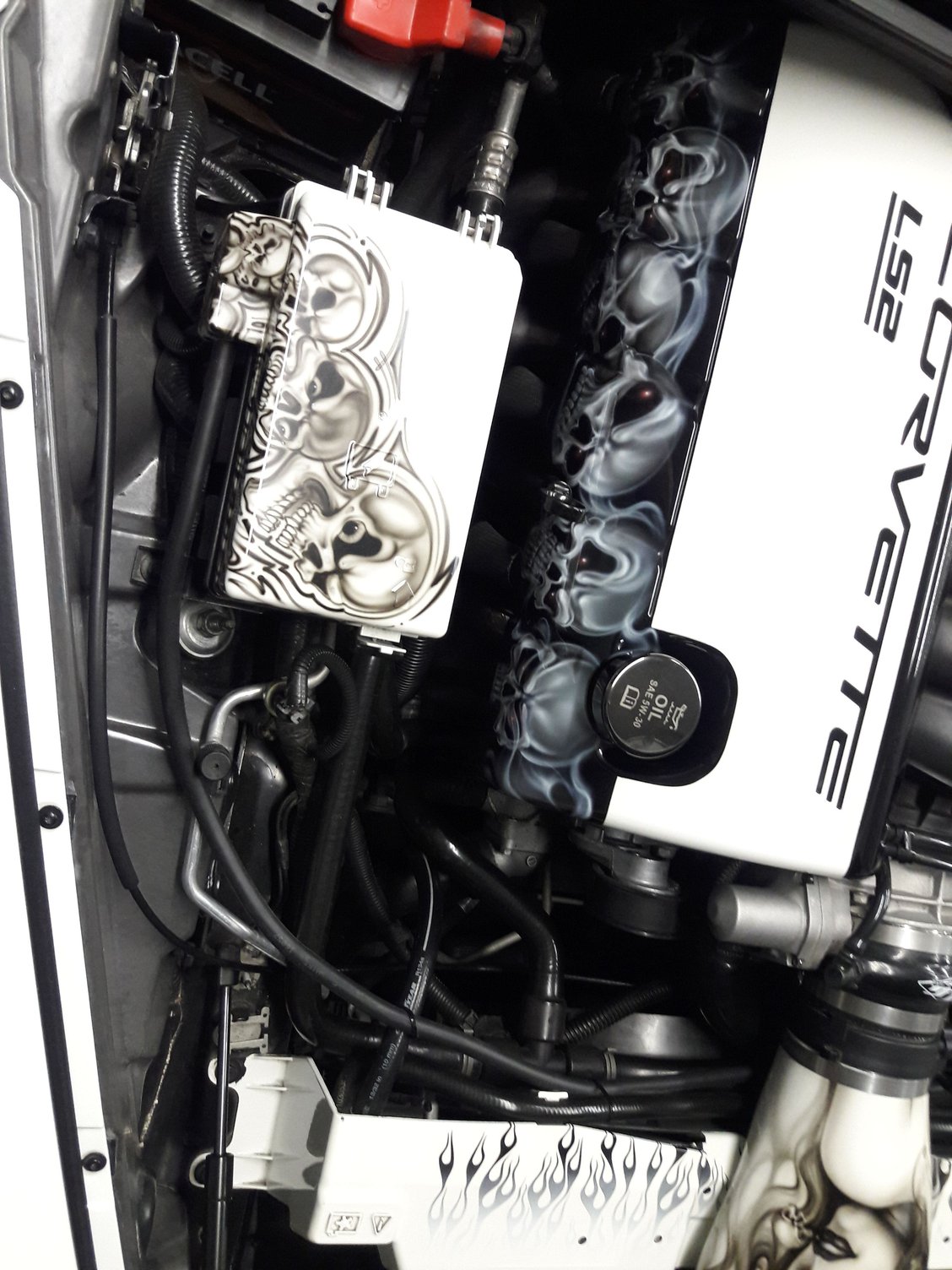

Cable routed along heater hoses to passengers side of eng bay.

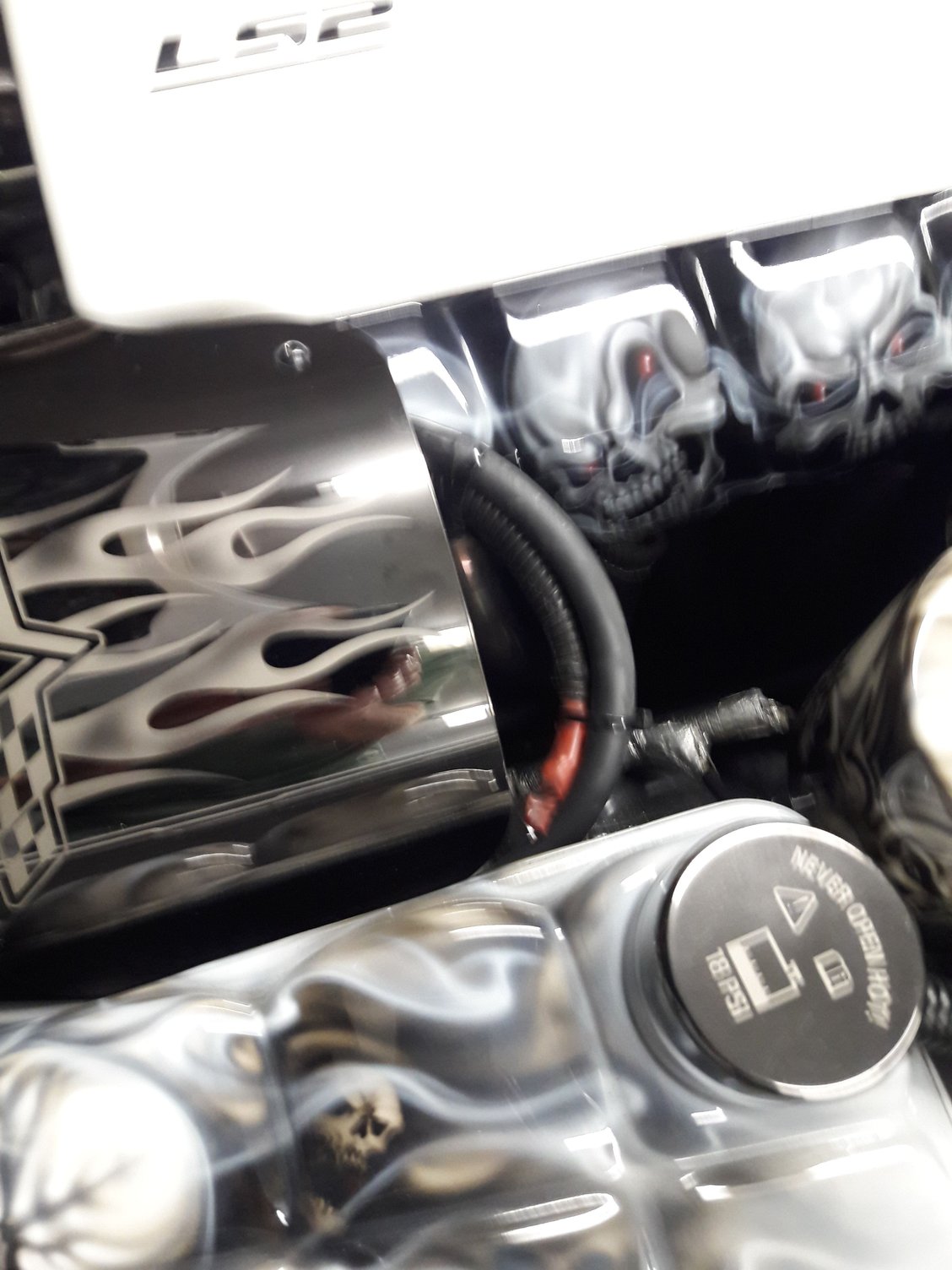

Cable going into fuse box. Trimmed fuse box cover so cable goes in with cover closed. There is a factory power point under the little kickout on the outboard side that the cable attches to.
This will eliminate the Voltage blockage at the starter.
