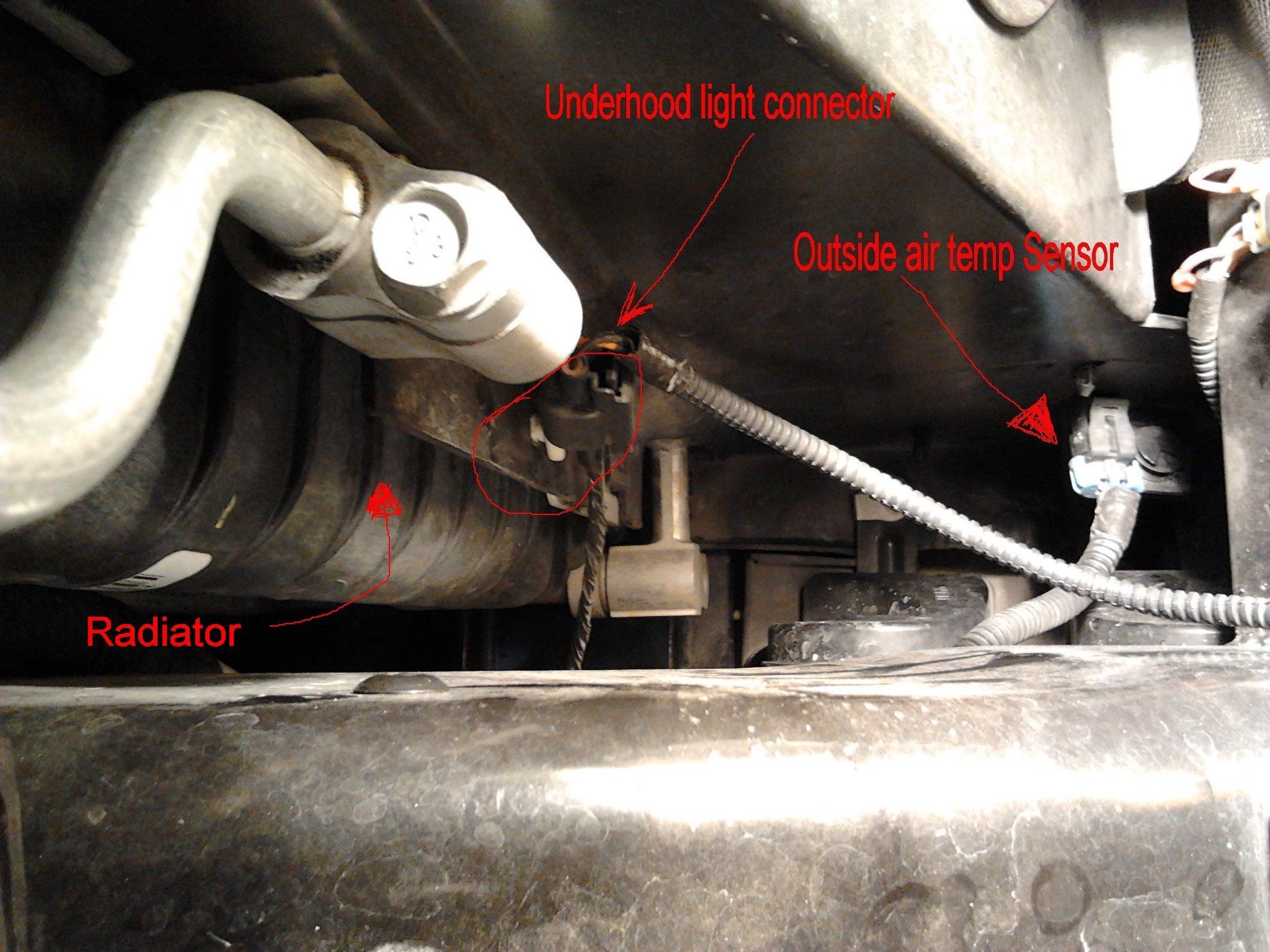

If you don't do anything, open a door, etc , it will time out and shut off after approx 10 minutes. If you leave the car in ACC, or do anything to the car, the light will come back on.
It's best just to unplug the connector by the passenger side of the radiator.
You could also solder splice in an inline shut off switch in the wiring just before the connector as well.

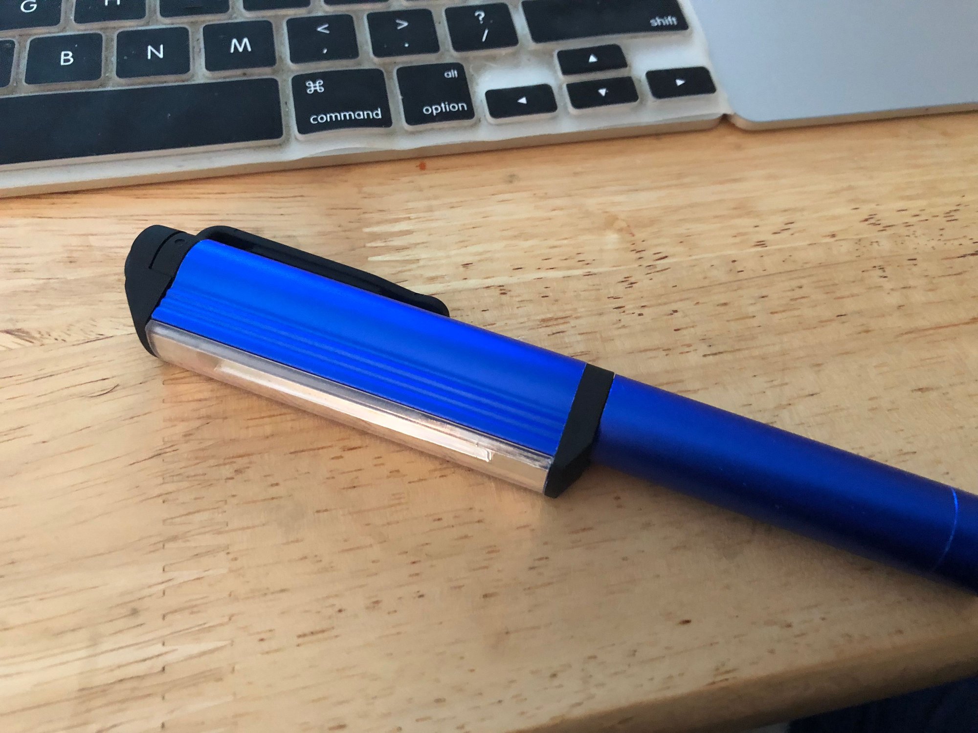

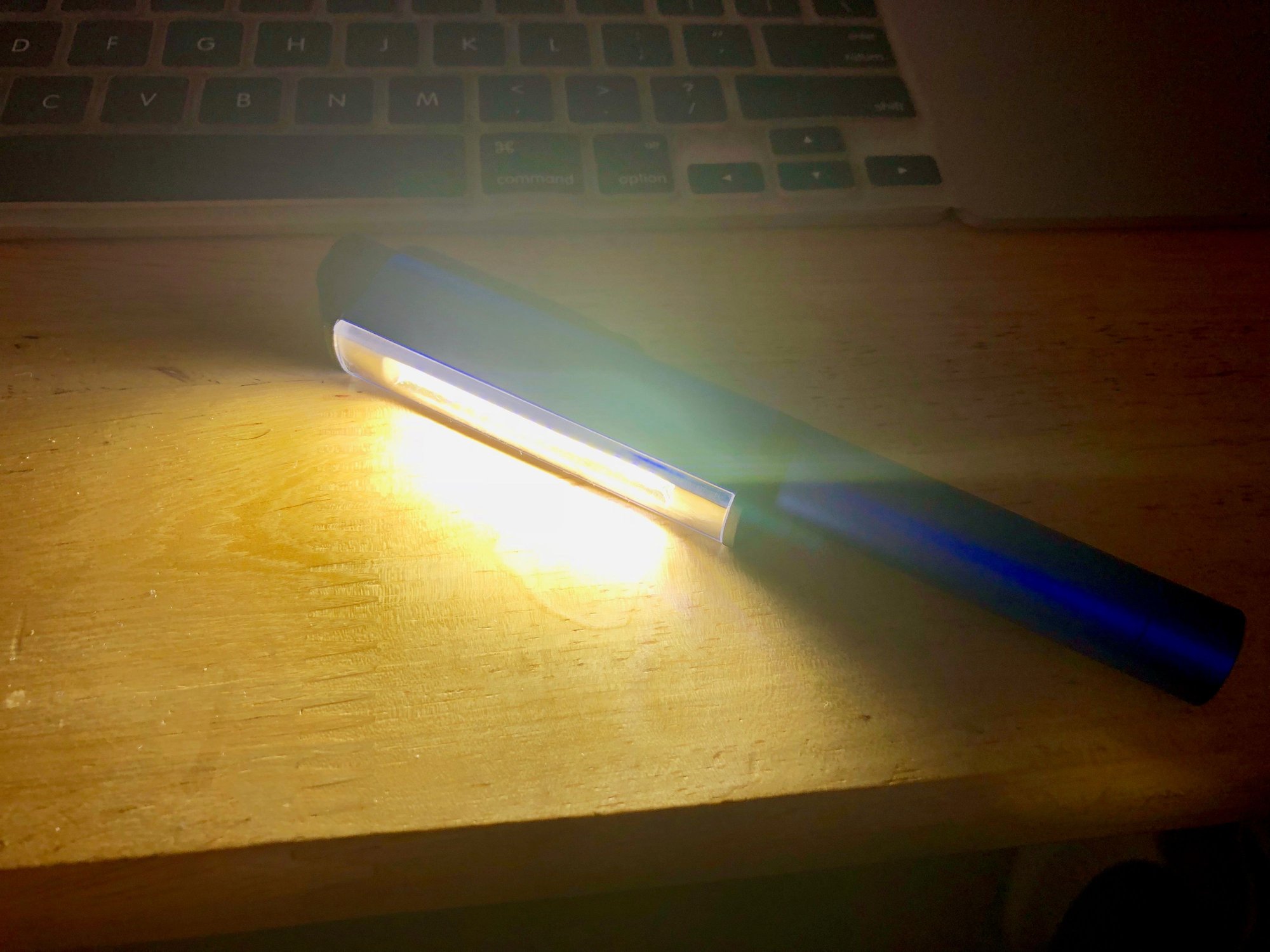

I put an inline rocker switch in mine… I can turn it on or off when I think I need it… Though you can get better/ more direct lighting from one of the little pocket LED flashlights that they sell at most car/ hardware stores for less than ten bucks. I recently bought these in a 3 pack at a local Menard's for $8.99
