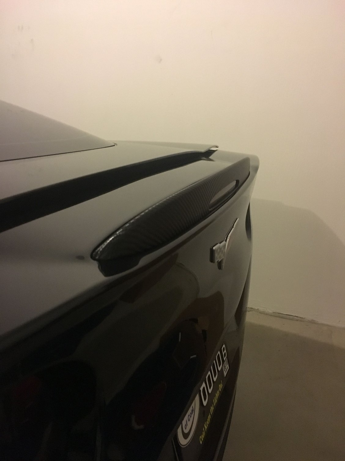

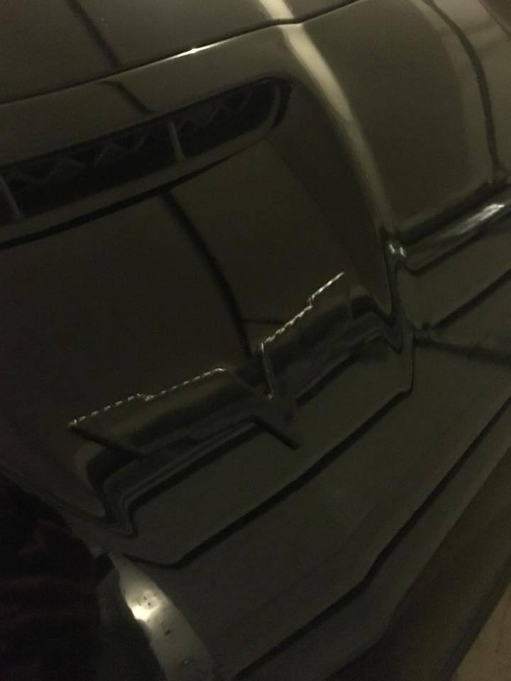

Old Nov 3, 2017 | 08:41 AM
EviLS7's Avatar
EviLS7
Joined: Apr 2017
Posts: 681
Likes: 99
From: Cincinnati
Had to do the badges, but added a insert to tie it all together and not be too much carbon fiber.
