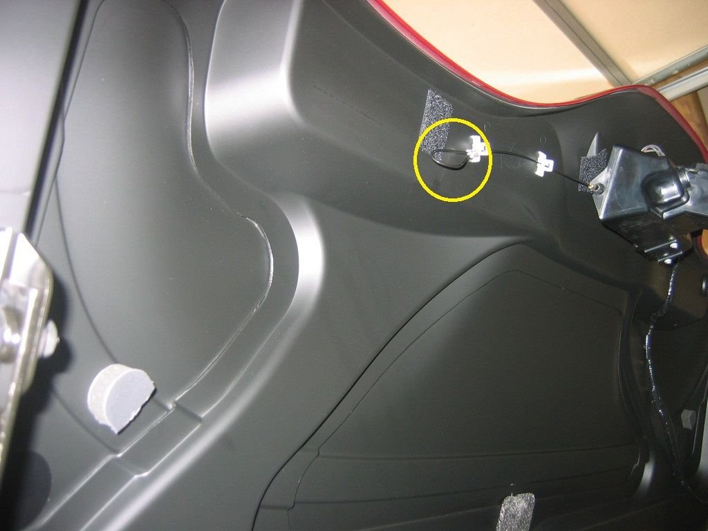

Yes, on the passenger side there's a cable you can pull to open it, it's on the underside of the lid, look at your owners manual and it'll show you where, or you can see it when you have the lid open.

The first pic shows the tonneau release pull and the second is the pump and pressure relief valve that you have to open when you want to manually operate a power top.
