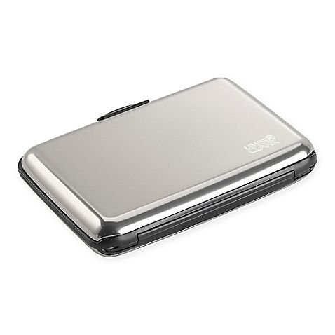

Here is a gift idea for your sig other:
Instead of wrapping the fob in foil buy a 'scan safe' credit card wallet. I saw them at Ace Hardware yesterday for about $10.
You're welcome...
