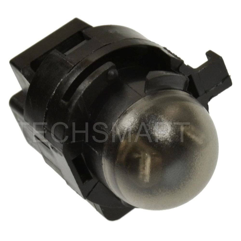

Has anybody else noticed that there appear to be two different types of these sensors? One has a smoked lens, and the other has a more frosted looking lens and it is oriented differently when installed. I ordered the GM part number that is called for (13498958) but it looks different than the one I took out, and it installs 90 degress different.
The one I took out looks like this:
But the new one looks like this. If you look, you'll notice the small plastic alignment arm is in a different position, which means the sensor gets mounted 90 degrees off. It seems to me like the orientation is important if you want it to catch the light from the proper direction.
Is there any readable part number on the one you took out?

Closer inspection reveals they are two totally different designs internally. I guess GM must have changed/upgraded them since my car was built.
