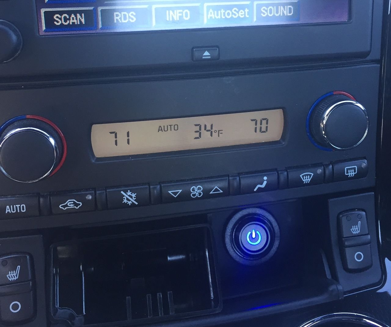

My C6 wasn't equipped with the M2W. It appears the "M2W in a box" was installed after the fact. I just purchased the car 3 days ago. I never got the remote and the dealership says they don't have it. My goal is to find one to use for programming to the HOMELINK.

There may just be a wired switch for it or some could be programmed through the garage door remote in the visor. Or it could have been like my ‘05, I installed the Z06 mufflers but never installed a M2W kit because I liked it open all the time anyway...
