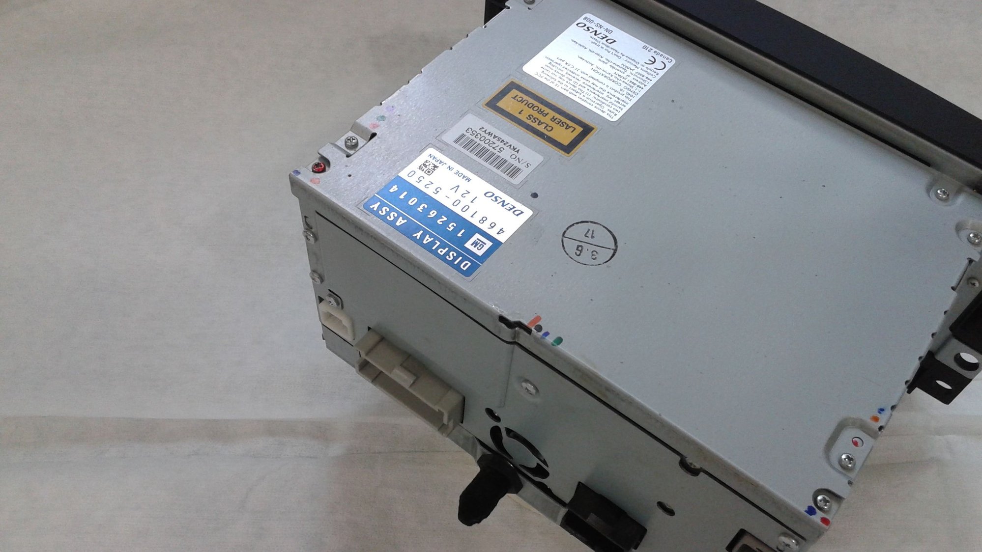

I'm having issue with 05 CD player. Pulled fuse for 30 min. Replaced and player worked fine for Collective Soul CD then I changed to Warrant CD and back to same issue (no disc found). So now I'll leave fuse out over night and try again.
Any other ideas??

Laser disc lens may be dirty (top surface of the top lens) or could be dust in the lower laser prism section instead.
So using something like can air, some times if the problem is the just the top surface of the top lens, you can get the dust off/ou,t so the laser works correctly. Other times, its the lower prism that is dirty, so you have to pull the radio apart, the disc player out of the radio, pull the laser cover plate, and get down into the lower section of the laser to cleans those lens instead.

The top cover of the Nav unit can be removed to access the laser lens for a manual cleaning. The lower prism may be a bit harder to access and manually clean.
With the top cover off, you can manually slide the CD table to expose the laser lens to manually clean with alcohol. Once cleaned move the table back to the park position, button it up, install power up and hope!
Not saying that that will work, but it may solve your issue.
