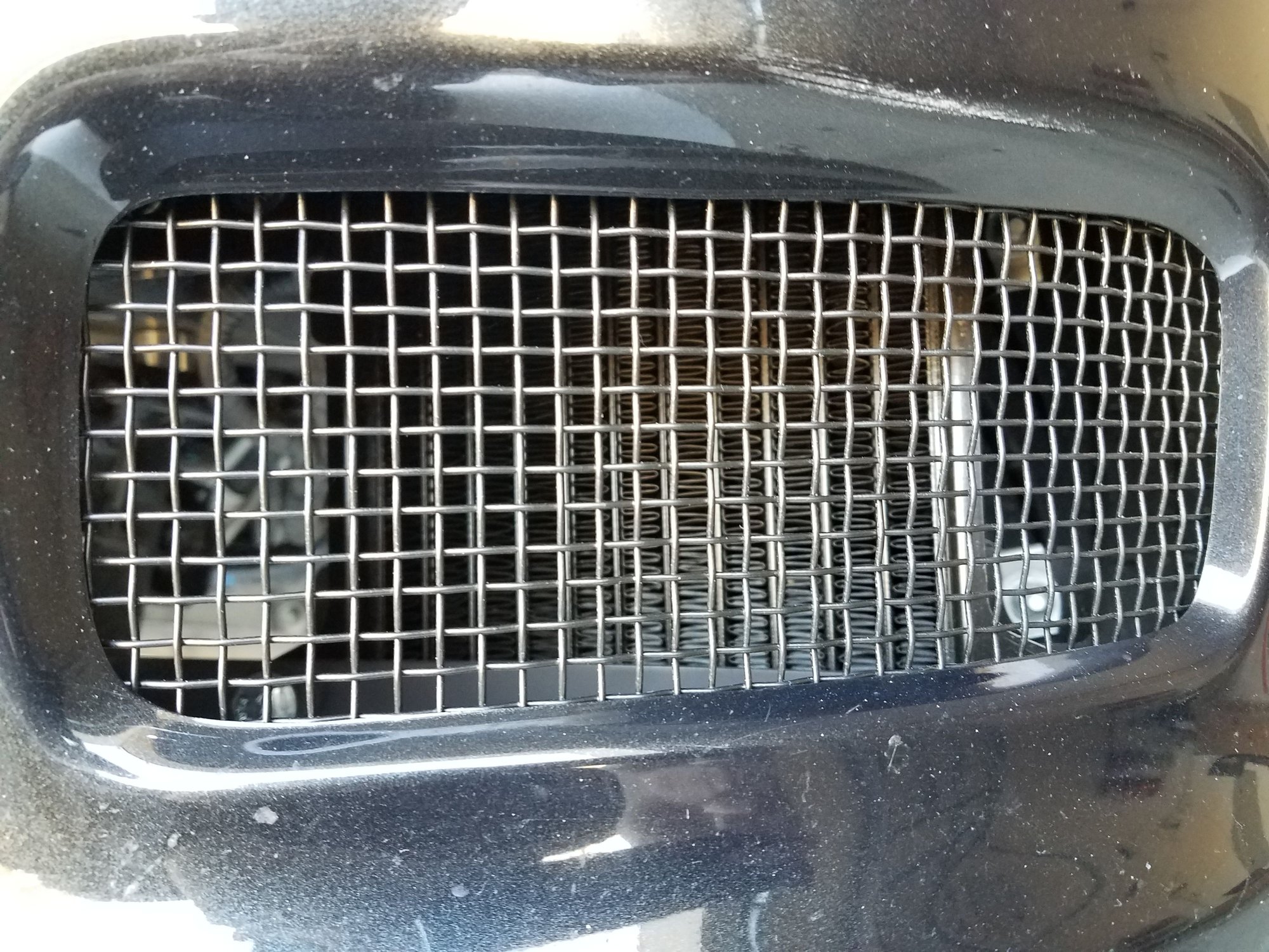

Here is a close up picture of mine. No problem with fog lights deleted. I actually used the fog light harness to power the fan for my trans cooler manually.
That's a pretty good idea.
