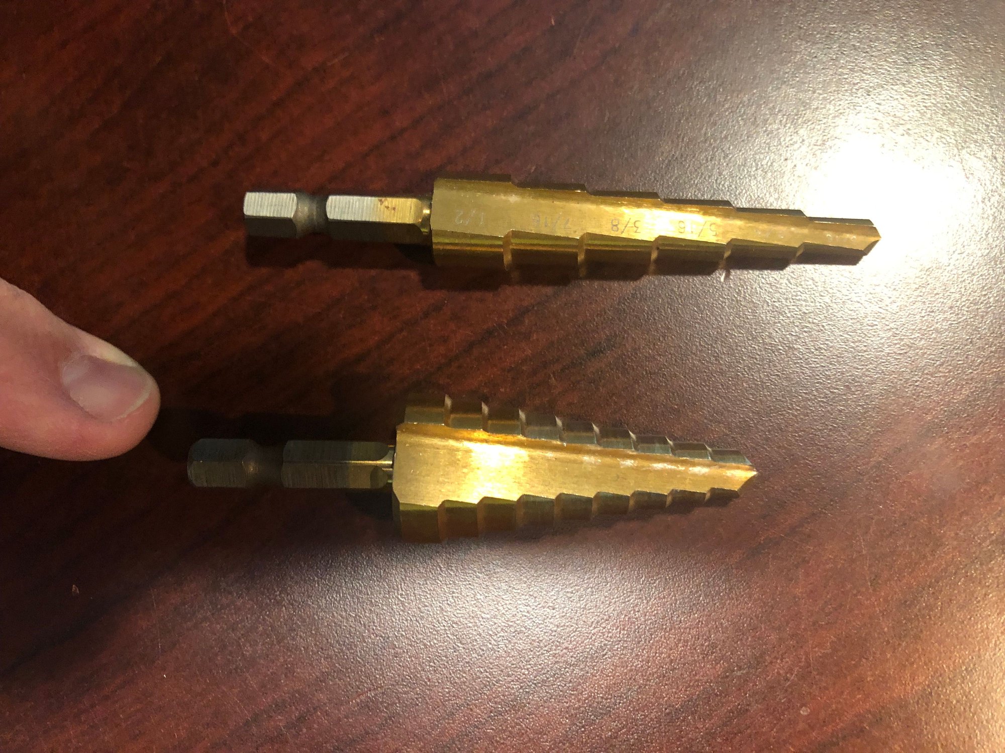

Originally Posted by Tracy
IT WORKED! IT FRIGGIN' WORKED!!
And it's soooooo easy to do. Now, having done it once, I could do the whole operation in 15 minutes.
First is the Mode Actuator (about $33 from RockAuto) and second is a 5.5 mm driver to remove the two actuator screws. Yes, I said five-point-five, which I had in my very well stocked garage, but I'm guessing many of you don't. You'll also need a 7mm to remove glove box screws, FYI. And a unibit drill. Get a short, fat stubby version like I'm pointing at. You don't want a long skinny bit that might hit something important on the other side before you get the diameter you need work with, which is about 1/2 inch.
So, if you have a B0248 code, or your system is wonky like we've been talking about here, order your actuator and get your tools. This great thread here [ [url]https://www.corvetteforum.com/forums/c6-corvette-general-discussion/4208263-hvac-b0248-error-code.html ] really tells you everything you need to know.
Oh, I did NOT have to replace the Blend actuator that I mentioned in a previous post ($29). When I went from Fresh to Recirc, I could see it working, located behind and to the right of the glove box. But since I have it, it's a real easy job, no drilling of support structures, etc.
You are my hero. I just picked up a 2013 grand sport and thought I was about to be screwed on this. I could NOT find that AC control stack anywhere. After seeing this post and the other post you linked about code B0248, I purchased myself a GM scanner of Amazon and cleared all codes and pulled the battery. This morning I tried the AC and immediately got codes B0248 and B3748 which both related to a faulty mode door. I will be picking up my mode door motor and a drill bit today. Hopefully that's all it is!
