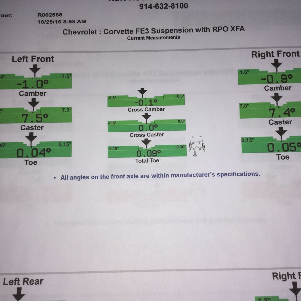

For the 1000th time PDFAT didn't create the specs they use. They just use GM specs when set to dead center and try to take credit. Here is my 2013 GS set to dead center GM specs, do they look familiar?
Sorry I bothered you with a repeat question. I did a search and did not find an answer to my question, I was looking for the specs for a 2008 base not a 2013 GS, is there a difference, I don't know and that's what I'm trying to find out. Also I don't know what you are trying to show me there is nothing attached in your post.
You don't have to be a rocket scientist to figure this out. TAKE any GM CORVETTE and set the GM specs dead middle of the machine, there now you have PFDAT SPECS! I used my car as a example, DEAD CENTER DO YOU UNDERSTAND THAT?
Produces a Cloudflare error. Also, no such thing as PDFAT. It's PFADT, and if you have nothing better to contribute, why don't you sit back and learn something?
Who cares whether PFADT created those specs or not? The point is PFADT created a document that many can use for their particular driving situation.
No you sit back and learn from me and stop giving pfadt credit were it doesn't belong. They ripped off gm specs when they realized their specs were the same as GM when gm's are set to dead center.
So now your admitting PFADT didn't create those specs, they copied and pasted them to a document of their liking and called them their own!

Originally Posted by Dano523
If you are going to push the car, then run oem specs isntead.
Hence oem alignment will have the inner side of the tire threads wearing faster if the car is not pushed from time to time; to wear the outer side of the treads at the same rate by pushing the car isntead.
I run Bridgestone RE-11 's on my 13'GS since the day I took it off the showroom floor. I had the alignment set dead center of GM specs within the first week. The tires wore perfectly even across and handled tremendous. I tossed them with about 40% tread at 18k just for the simple fact I wanted new ones. I am on my second set now with 7k miles on them and they still look brand new. like I said these are what I tell my tech to set them to, just put them dead center (where PFADT robs there specs from) of GM.
IIRC, 4 of the 5 specs were towards the middle, and one was not.
The PFADT name was just a convenience to let others who have seen it on here many times know what we're talking about.
And the GM name is a bigger convenience! Their the ones who designed the numbers, not PFADT. You want convience just say GM DEAD CENTER. No need to call numbers out to a tech to then transform them on a alignment maching. Tell you tech, gee mister do you see the green bar, could you but that black little line in the center of the green bar, gee mister thanks.
