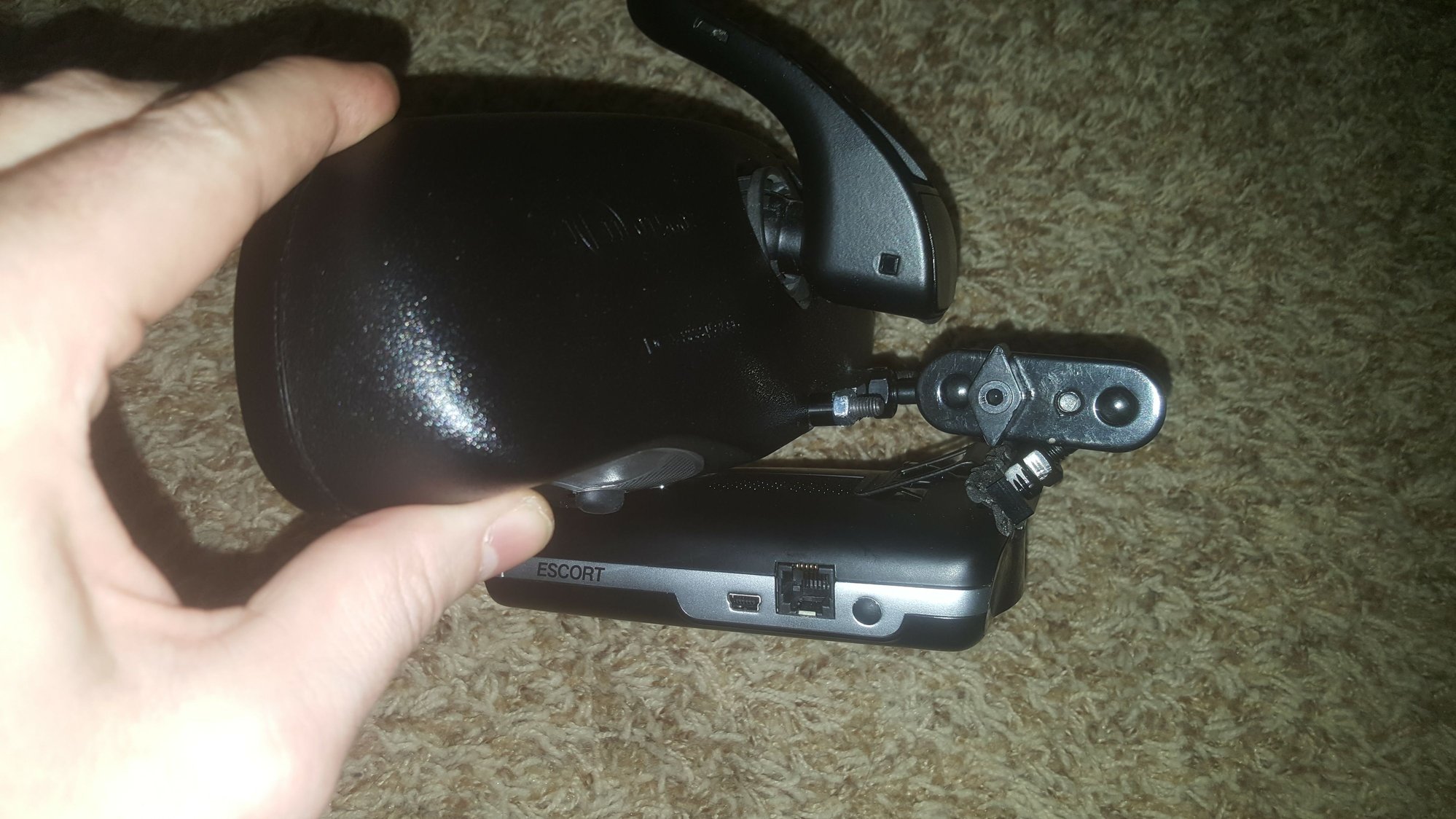

It's definitely not glued. I took mine apart last year to build a custom radar detector mount and it just took a few minutes.
I can't remember the details but it's only a few screws holding everything together if I remember correctly

I'll try to find some time this weekend to pull mine again for more info. Unfortunately I didn't take any pics of the process and my memory is blurry. I just remember it was easy.
But you can see by the pics below I had to take everything apart to pass the radar mounting bolts through the rear casing and secure with nuts from the inside.

Left hand in the second pic. There has to be pressure placed along that seam which separates the two pieces at that seam to where it either "pops" apart or gives enough space to insert a trim tool to push/pry the two pieces apart.
When I pinch, nothing seems to move. It seems as if the glass is keeping the two plastic halves from bending in anyway so I cannot get a pry tool into the space.

I think you're probably right. I wish I could tell you with certainty, but until I pull mine again I just can't remember. I can tell you for sure that I've had mine apart a couple of times and was able to put it back together without breaking anything. I feel like I remember the glass being a separate piece that is floating and not connected to anything. But then again, I was thinking I remembered screws holding things in place.

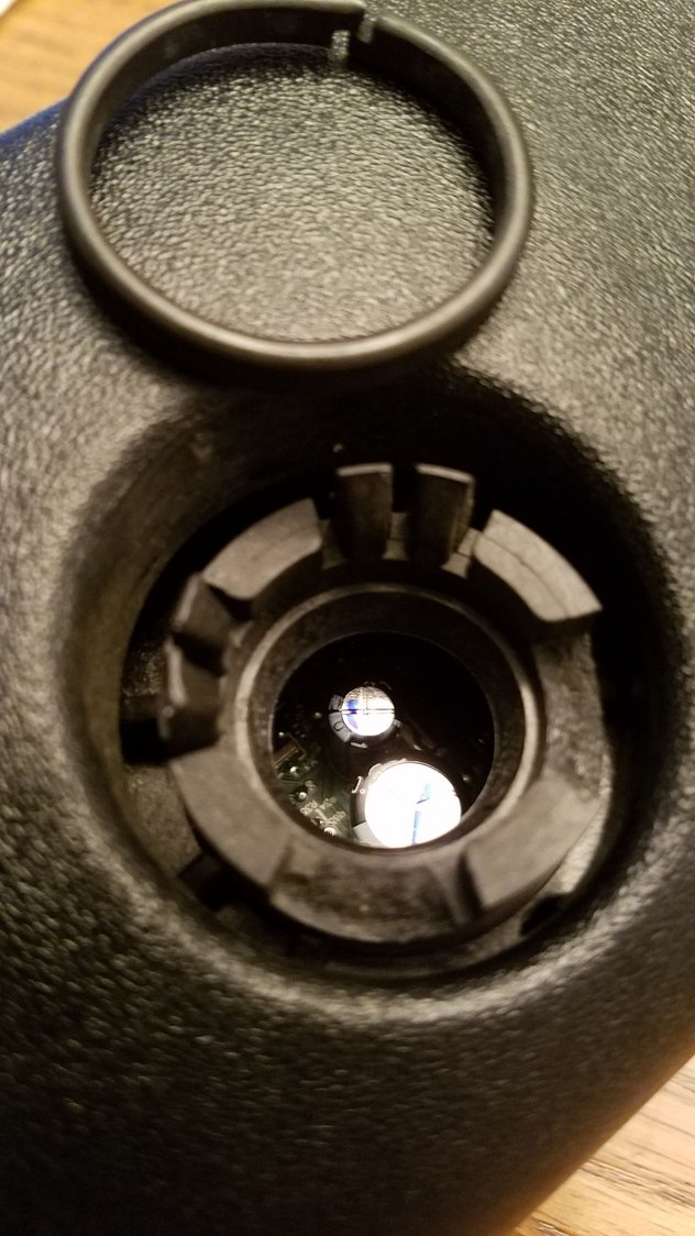

Here are a couple of videos. The first shows how to open the shell of the mirror and the second shows how to remove the mirror from the shell.
Opening the shell is easy. It does take a decent amount of pressure at the seam, but once you can get something in there it pries right open. I'd use something plastic so you don't damage the housing, but you could do it with a butter knife pretty easily.
When you pull the guts make sure you unhook the harness wire from the channel in the back or it will get stuck on the way out. There are some pics of the innards and housing at the bottom. I'll keep it apart for a few hours in case anyone has any questions.
Everything just clips back together when you are done.
